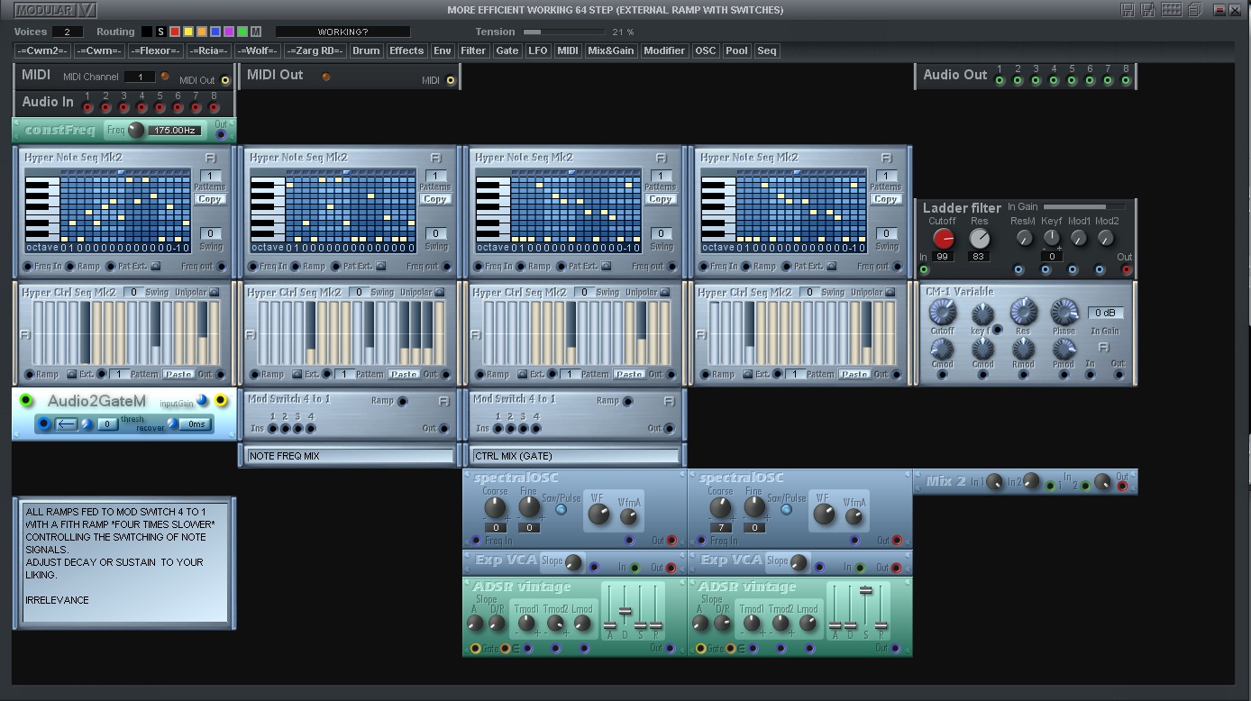

More sequencer/gate/external ramp fun! Ramp file included and quick vid to show what's going on:

64 step sequencer (external ramp)

Re: 64 step sequencer (external ramp)
Cool glad you can find use
Been spending time in max for live (max/msp) which has got me thinking in a modular way again.
This patch can be extended to 128 step in one shell with the flexor mod switch 8 to 1 however if running with external ramps you run out of inputs into mod shell. So either spread the patch across two shells or use an internal ramp for master ramp duty and be sure to gate it to keep time.
Hi irrelevance,
Good to see you're still building patches! Are there actually more than the two distinct ramp signals involved? If not, why don't you just distribute them within the patch, rather than having to use lots of audio inputs?
It's probably just me not understanding properly, so if you do need more inputs, you should look at the BC Modular shells, e.g. BC882416. That one has 16 sync connections that you could use, for instance, and you'd still have 8 audio inputs available.
