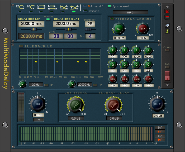

Free MMDelay
Post by Peter4724 »
Hi all
have funn
r
Peter
Multi Mode Delay.PNG (351.89 KiB) Viewed 10648 times
