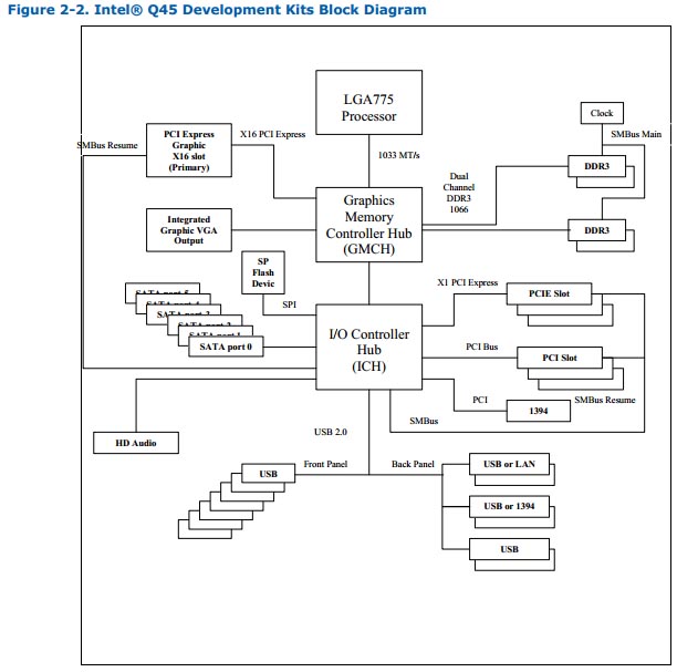

and here's the block diagram i found at Intel:
Intel Q45
Intel Q45
Re: Does this motherboard work with a Pulsar II
yeah, it should work.
you know, since it's a mini tower, the real question is "will the card fit in the case?"....
Post by katano »
well, it's called a mini tower, but the manual states there's room for 2 full lenght pci cards...
I'm more worried with all the onboard stuff I don't need..
well, that's not a problem. just disable ports you aren't using in the bios. if there are irq issues between Scope and usb, you can disable the offending usb contrller in the device manager. i find that newer motherboards(socket 775 and later) generally work with little hassle. you will need to disable power stepping and the like, but this is for performance over power savings, so it's a small issue as well.
