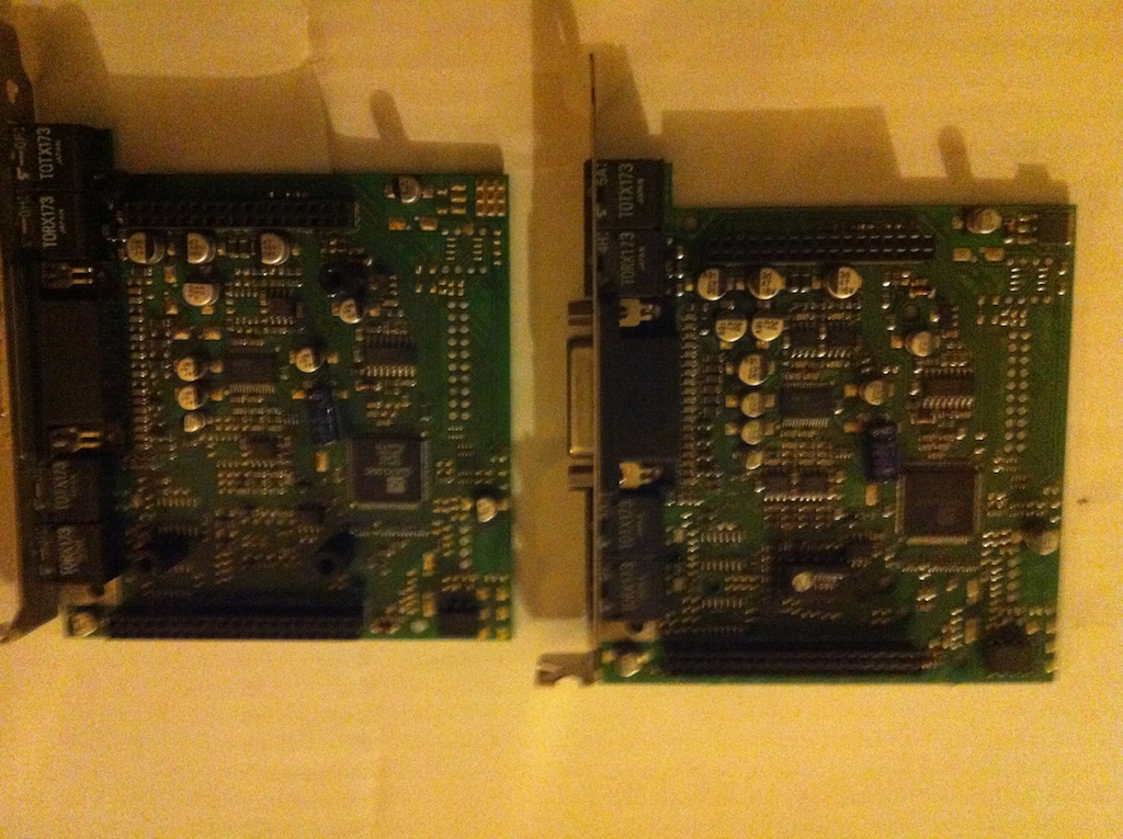

Classic I/O - Plus I/O
IMG_0282 copy.jpg (354.07 KiB) Viewed 4626 times
Here's a picture of a Classic I/O (left) and a Plus I/O (right). Two extra caps on the Plus.

And a voltage/current regulator too, from what it looks like.

i would say its a balancing ic as it has balanced i/o plus the extra dc blocking caps
Re: pulsar2 Classic or Plus?
yep, you can see the extra ic on the corner and another towards the middle. the one towards the middle has an extra cap.
