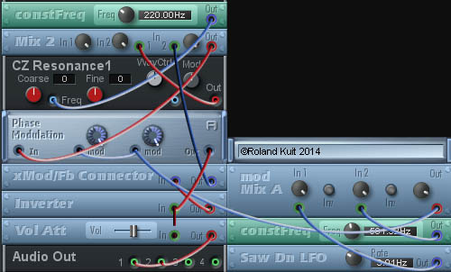

Saw this vid the other day and was wondering if or how this could be made either as a device or possibly built using various modules in Scope Modular. A really nice sounding effect particularly interesting at around 29 seconds, and again later on in vid.
http://m.youtube.com/watch?v=mqh8jxF89y ... qh8jxF89yI
Seems to be based around or related to ring modulation
http://electro-music.com/forum/phpbb-fi ... od_140.pdf
Any developers out there interested in having a go at this?
Cheers :)
Edit: just saw the following related request
http://forums.planetz.com/viewtopic.php ... cy+shifter
So will take a look at the frequency shifter module and see if that will do the job. But I'll leave my post here in case anyone wishes to reply. Thanks lads.

Post by Roland Kuit »
I can do that for you.
I just wasn't sitting behind the Xite(yes, I have it still here).
This was done with the Clavia NMG2Demo on my tablet in the train.
You can find this here:
http://www.clavia.se/products/nordmodular/demo.htm
As I told Holger, it would be a great tool to make something like this(Demo) for the modular Scope versions.
Than you can work any time and everywhere.
As a start, all was developed in a pc and Demo shell.
I would keep the Xite-1 when such a tool was there.
Tweak the the modules on the right.
Phase Freq.rar
(543.86 KiB) Downloaded 225 times

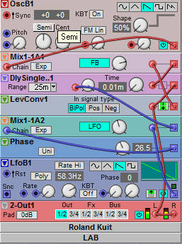

roland in bc modular there are clm shells for designing circuits
you can send these to sharc of bc modular and he will create the module
but as seeing you have the sdk you can also join the developers group
as we are discussing new modules using the scope guisdk using host cpu modules

http://bcmodular.co.uk/downloads/BCMODULAR_0_971b.zip
this is the full modules
you create the circuits you want with a clm shell these are small circuit shells that you can create custom circuits in the save them and recall them with out having to remake them
very handy for user sub modules
i create fx and filter types resonators and save them
and if i create a synth and i need this basic building block i then load a clm shell and call up the preset of the one i made before which it loads into the shell
the shell has async sync i/o and audio i/o
the async ins can be used for control and gate signals
if you have a module you like you can then send it to sharc and he will create the custom module for you with credits to you
its a great way of getting new modules in the modular
i did a polymoog resonator
