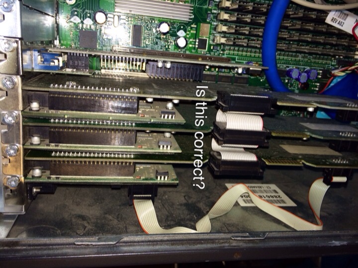

1)First of all, here's a picture that shows how the 3 Pulsar2 cards and Syncplate are connected:
Is it correct? Are stdm cables correctly mounted? I could try moving the connection to the other slot....does it make sense?
Notice the red mark on the stdm that links the three cards...is it on the correct side?

1. yes, that looks correct. you can try connecting the syncplate to the first card to see if it works better, but it shouldn't matter that much. the red mark doesn't matter.
