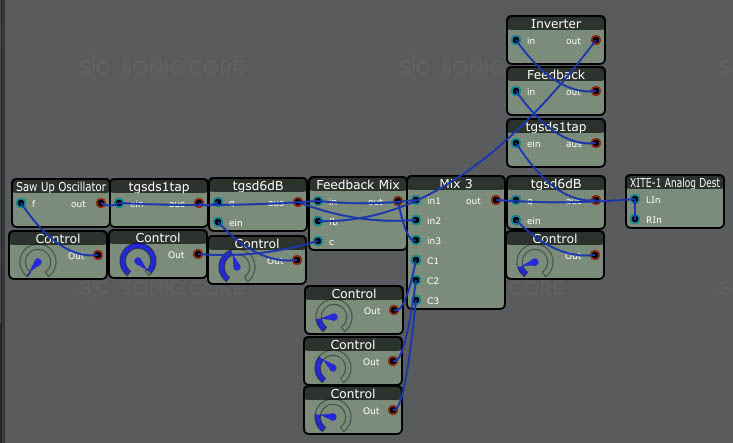

Re: IRR Filter desighn
With compliments to tgstgs modules:
A Schroeders All pass filter
- Schroeders Allpass.rar
- (4.01 KiB) Downloaded 421 times
- Roland Kuit Schroeders Allpass.jpg (55.42 KiB) Viewed 8255 times
http://www.rolandkuit.com/
Looks good Roland
Thanks Shark, but I have to test the mixers. In this case they must be linear.
Tomorrow an other day.
