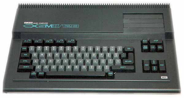

No the Yamaha CX5M was built specifically for music and came several years before the Falcon (1992), although the MSX spec was more general purpose, this baby I owned (from 1985) had in built 4 Op FM synth (multitimbral) as well as MIDI ports for my DX7.
With Abdul Ibrahim's DMS 16 track MIDI sequencer timing was rock solid, and you could play game cartridges with it whilst the client was having coffee.
Never, ever crashed once, unless you removed cartridge with the power on :o :lol:
CX5M Mk II
CX5M Mk II
