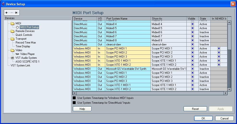

Im able to address 2 different sets of Scope ports in Cubase without any problems. But the 2 versions of Scope are active. So Im not sure if I removed one Scope version if Cubase wouldn't know its not available anymore.
Either way, its possible and not unusual to have many MIDI ports in Cubase. Of course, if you have 2 Scope MIDI input/output ports registered in Cubase, that will only work if you are running a Scope project with 2 'sequencer midi source' / 'sequencer midi dest' modules active and connected.
Cubase Ports.
Cubase Ports.

the number of midi ports that show up in Cubase are determined by the setting in the card's properties in the device manager. 2 is default. of course, to use both, you must have two pairs of Sequencer midi modules in the routing window BEFORE opening Cubase.
