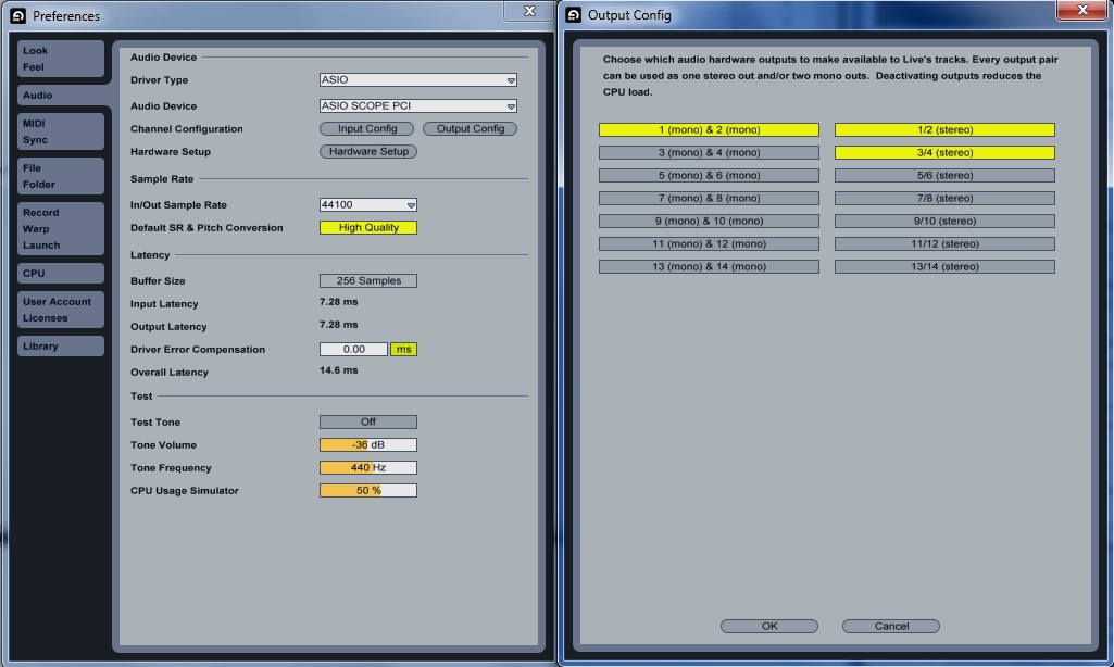

Re: Ableton could not open scope asio
First off, Gary is right regarding the external outputs. look below...
From preferences you go to output config and enable your outputs by clicking them. Available outputs depends on how many outputs you have on the ASIO source module in your Scope project.
