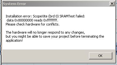

hi all,
after 3 hours things got even worse ...
- did a cleanup of old registry entries for scope pci entries = didn't help
- unchecked every power saving setting I cound gain = didn't help
... sope software started but after playing back some tracks in cubase ... copy violation ...
- did a fresh installation with downloaded version of scope xite-software ... copy violation
... then some new errors occured: dsp1 could not load satellites ... no gain to hardware ... hw 30 detected and so on ... communcation error ...
so now I turned off everything because I dind't even have success starting the scope software ...
will do a last testing tomorrow with another hdmi cable ... if that doesn't work xite will be returned. we will ask sc support if they can check the unit ...
will tell ya tomorrow what happend ...
good night
tom

some more errors ..
- xite_err06.JPG (29.58 KiB) Viewed 4232 times
- xite_err05.JPG (28.9 KiB) Viewed 4232 times
- xite_err04.JPG (12.82 KiB) Viewed 4232 times
