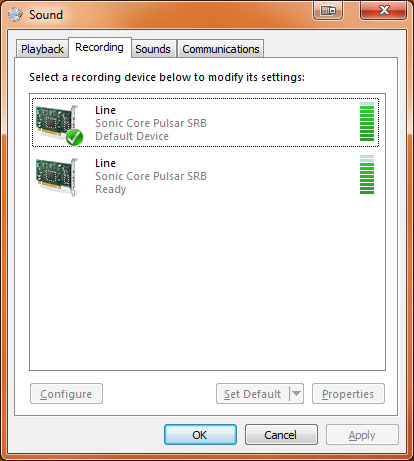

I seem to have a bit more issues in 64-bit mode than I've ever had in 32-bit Windows XP.
The topic of the day here is my Wave Dest software inputs are so noisy they're not usable. For the most part when I'm using SONAR, it's not a big deal since I just default to ASIO. But when that's not an option for whatever reason in Finale, Sibelius, & StroboSoft due to crashing when ASIO is selected, I am left with using Wave IO of SCOPE.
Playback does not have any issues but when I need to use input (for example to use StroboSoft to tune my guitar or something), I can't use because the noise is too much.
Another interesting note on the problem: on these Wave Dest devices, left channel is picking up all the noise & right channel picks up nothing, no input, no noise, just not working at all.
Anyone else ran into this issue in Windows 7 x64?
Sonic Core Pulsar SRB Recording.jpg (74.46 KiB) Viewed 1311 times

there is a problem with the wave source in 64bit. it has slight and random crackles. both l and r work fine here, though. the issue i described is a known one. it'll get fixed.

I have exactly the same problem, well, it seems we r waiting new scope update, I hope I won't be too expensive B-)
