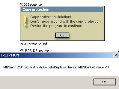

It is a desktop pc so the cable is safely at the back and doesn't get moved. It works for about 15 minutes then it crashes.
It just crashed now and I got a screenshot of the message. It seems to be about midi but I have tried loading Scope without any midi cables attached - usb midi and the standard midi cable through the xite 1D - but it still crashes.

Re: Xite-1 D Ongoing Problems
bad power supply or hdmi cable, most likely.....
Post by xite knight »
I used to get that copy violation message frequently. To make a long story short, the problem diappeared after I made sure that all my studio equipment (in particular the xite and the pc) is connected to only one (grounded) power strip.
Post by bigdealz »
Yes, it seems to be power related, so I am checking that now. Hopefully, that's what the problem is.
that error will always manifest when the computer and the XITE stop communicating. there are several reasons for that to happen, but interrupted communication is pretty much the ONLY time you'll see that error.
