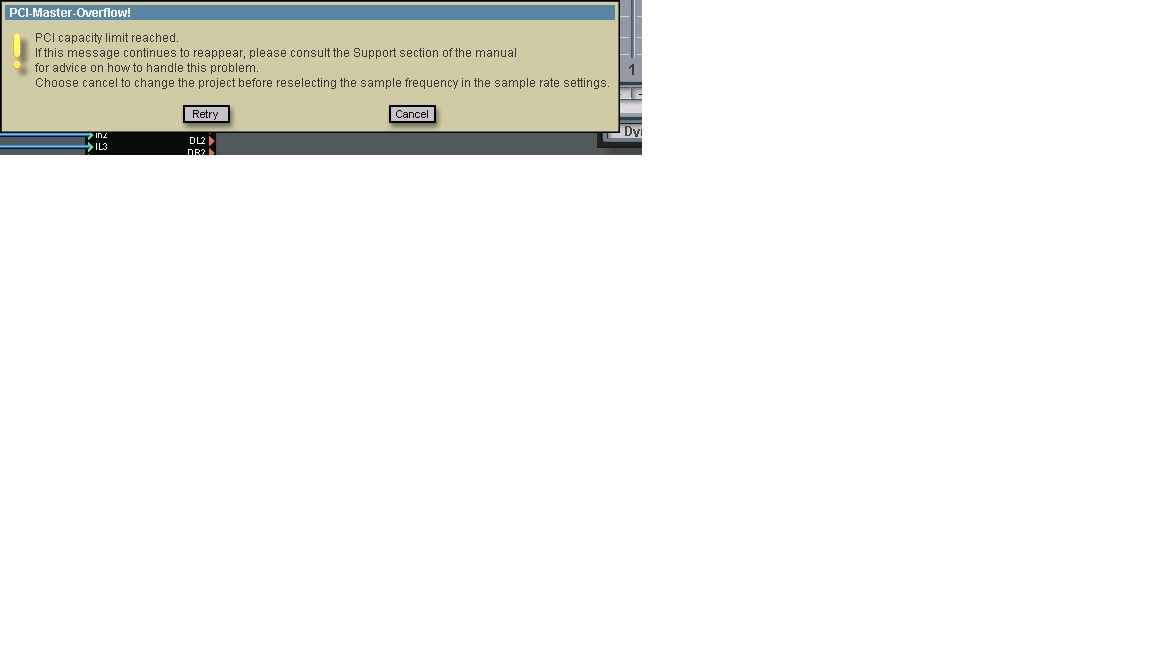

Hi all,
My bandmate bought a new PC but gets PCI-bandwith errors. he doesn't speak english so I offered him to put this help request on planetz ... I am a using RME stuff but do also own to pulsar 2 cards, so I am a little bit familier with scope ...
Ok, we did some testing on MY old system and everything worked as expected even a16 connected to one of my 2 pulsar cards. so I thing A16 should be OK.
Some info about the new PC:
Hardware:
ASUS P8P67, i7, 16 GB RAM,3 HD,Scope 15 DSP,A16 ultra,3 monitors 24",ATI Radeon 6700 series
Software:
Windows 7 64 bit,Cubase 64 bit,Scope 5.1,
Omnisphere, Trilian, RMX 64 bit plugins
BIOS already updated
graphics card driver up to date.
A16 checked on an old system - excellent
A16Ultra connected as slave to Scope card (Master) via ADAT. Sync via ADAT, 44,1 KHz.
All unnecessary Services disabled
all energy savings disabled (in Windows and BIOS)
bluetooth disabled, realtek audio disabled, usb 3.0 support disabled, 1394a disabled ...
Error: PCI Bandwidth limit reached

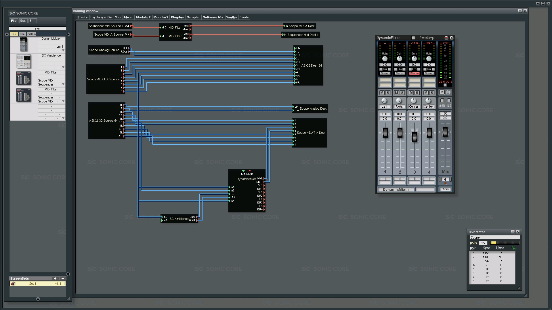

1. we get this message even with only 8 channel connections routed directly inout (without any other mnodules, synths ...
2. Using the scopecard alone works like a charm
3. wihout starting cubase we are also able to load many modules.
as soon as we start cubase the possibility to chrash/get the above error message increases. we can provoke the error just by playing on the keyboard (e.g. modulation wheel ) and sending midi. after a few seconds the message appears. sometimes the pc even crashes (BSOD :-(
We have already contacted SC support - no way ... they cant't help.
any ideas, hints on what we could do?
should we try 32-bit cubase?does that make sense?
Is there a way to force the systems to use an interrupt exclusively for the slot with the card (ASUS manual shows serveral "shared" in the IRQ-matrix)
greetz
tom
attached 2 pics of routing an error message

sorry. sandy bridge motherboards and processors do NOT work well with pci cards. they don't have REAL pci slots. the pci bus is tacked onto the pci-e bus and it has very limited bandwidth. the manufacturers of the boards(and intel with the chipset design) never expected anyone to be using a high performance realtime audio pci card with those systems.
it's unfortunate that everyone thinks they need the latest model(since older models have almost the exact same performance for most users). this is how the computer world works. he'll either need to downgrade his computer to a socket 1156 or 775 machine, run a different card, or sell his pci cards and get an XITE.

the socket 1155 motherboard and processor with the p67 chipset is the problem. the only possible solution, if he wants to use the pci card, is to sell the motherboard and processor and go with a socket 1156 solution.
yes! the XITE is a definite solution. it works the same way as the pci cards, but it uses the pci-e bus instead. the p67 and corresponding motherboards and processors work very nicely with it. in use, he won't notice much difference in the way things work compared to his pci card, except that the XITEs sound so much better and have much more power(even the XITE-1D is 2 1/2 times the power of his 15dsp card).
be brave and tell him. it's better to face the truth and suffer for a minute than to avoid it and suffer forever. :)

if you have a p67 board, it may or may not work.
there is NO native pci support on that chipset. a third party chip controls the pci bus and there are many problems. where are you hearing this from? it might just be S|C technical support.
one could always try bios updates, and even another of the same motherboard, they seem to be variable. i'd call them a no-go, especially if you want to run a reverb or two.
one will definitely need to check for anything that shares an irq with the Scope card(s) and disable it if it's usb or something that won't be used. also the usual i3,i5,i7 bios tweaks need to be done, disabling:
Intel EIST
Intel C State
C1E Support
Overspeed Protection
Hyperthreading
Execute Bit Support
Set Limit CPUID MaxVal to 3 (maybe not so important)
Intel Virtual Tech
Intel VT-d Tech
there's nothing else to do. if the bus doewsn't work correctly, then it doesn't work. on a p67, the pci bus is for legacy soundblasters and network cards. you are expected to buy new pci-e expansions, that's how the computer business works.
the thing is, a socket 1156 motherboard and processor would have been equally powerful in real life use with audio apps.
what the hell are the technical specs of the board that you don't use a Scope card with supposed to do for me? do you think i don't know what that motherboard is? it's nice that yours worked, but there are many more people who have been terribly disappointed by that chipset's pci performance, which may be the worst of any motherboard ever manufactured since the dawn of the pentium. usually, they DO work, but they never work well, not compared to 1156 and 775 machines that are really just as fast for most audio uses. if you're using massive amounts of samples or playing video games or doing video rendering, the sandybridge machines may be an advantage, but not for 99% of audio work. for this reason, i never recommend a sandybridge machine for a pci card.
