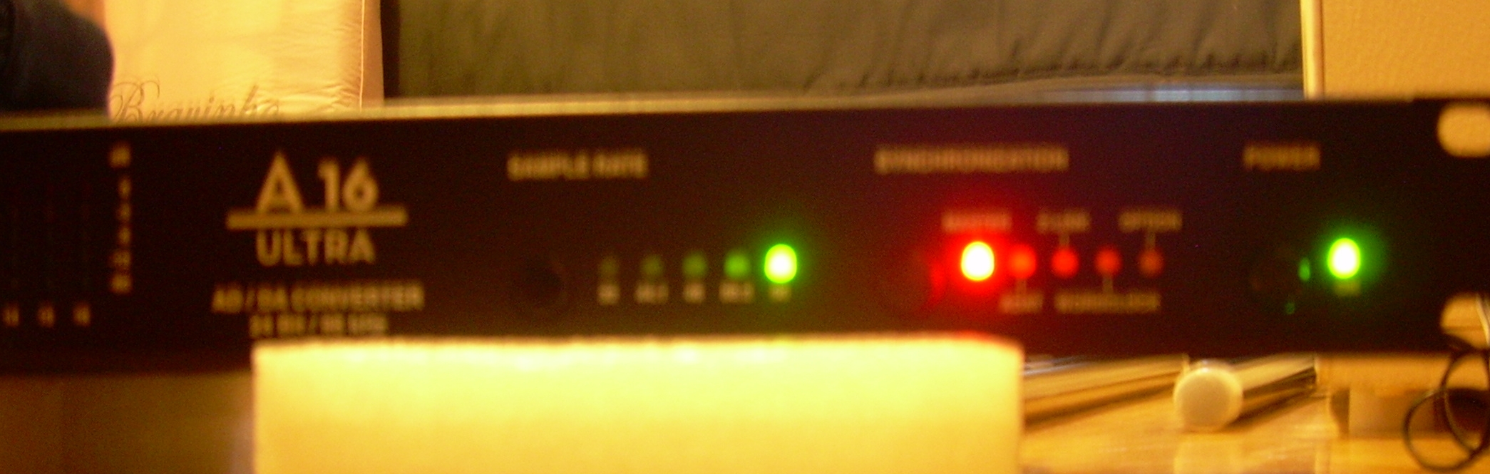

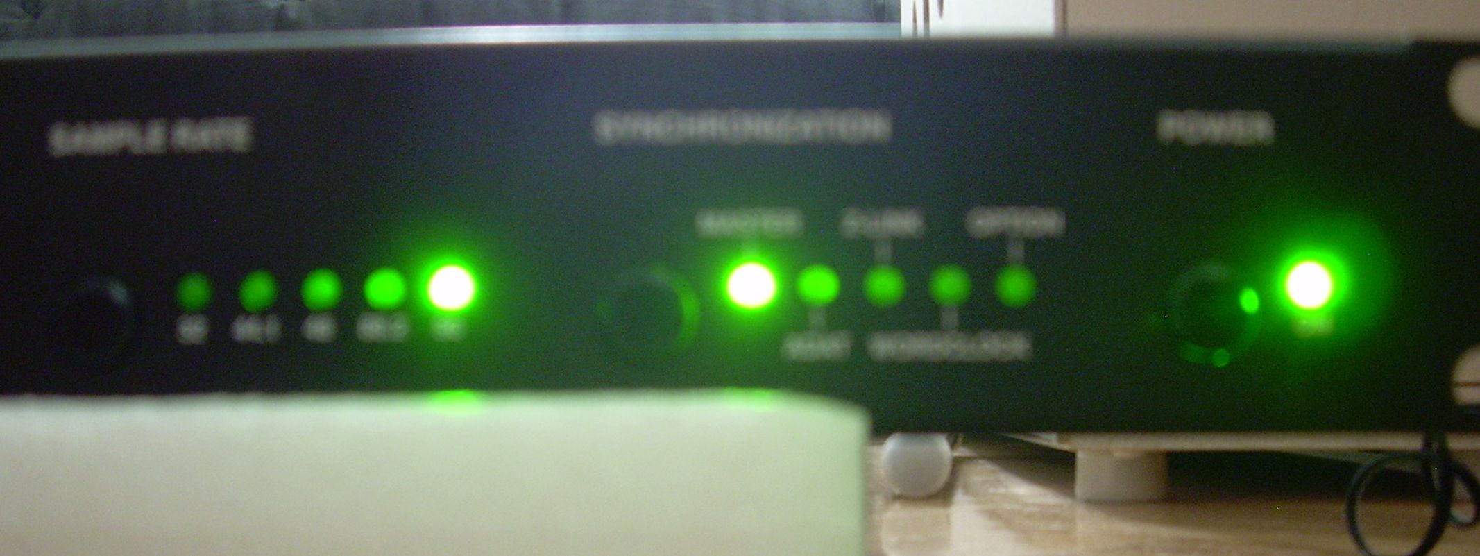

Hello. After 15 minutes working my SC A16 Ultra (black face version) get out of sync (sync led go to red) only in 96 kHz and 48 kHz. The same happens if set A16U in wordclock and setup my RME fireface 800 as a master. If I turn off A16U for a 10/20 minutes and turn on again, green led appears again, but after 15 minutes red led backs.
SYNC: Master (green led before 15 minutes, them goes red )
SAMPLE RATE: 96 or 48
SYNC: Wordclock (green led before 15 minutes, them goes red )
There's any solution, or I should contact SC support?

I try sync in wordclock mode:
1. RME Fireface 800 master, SC A16U slave, WC cable goes from RME Fireface 800 WC out to SC A16U WC in with a T adapter and a 75 ohms terminator (I try without terminator too). Everything goes OK, but after 15 minutes SC A16U lost sync in 96 kHz and 48 kHz but still work at 32/44.1/88.2 kHz.
2. SC A16U master, RME Fireface 800 slave, WC cable goes from SC A16U WC out to RME Fireface 800 WC in terminator botton enable (I try without terminator botton too). Everything goes OK, but after 15 minutes SC A16U lost sync in 96 kHz and 48 kHz but still work at 32/44.1/88.2 kHz.
The same happens if I don't connect anything to SC A16U and wait 15 to 20 minutes.
PS1: My tester read in SC A16U Transformer 15.9 VDC (+/- 0.2 VDC)
PS2: Thanks for the support.
- After 15 minutes
- SCA16UAfter15MinutesWorking.JPG (799.42 KiB) Viewed 1880 times
- Before 15 minutes
- SCA16UAfter1MinutesWorking.jpg (205.84 KiB) Viewed 1880 times
