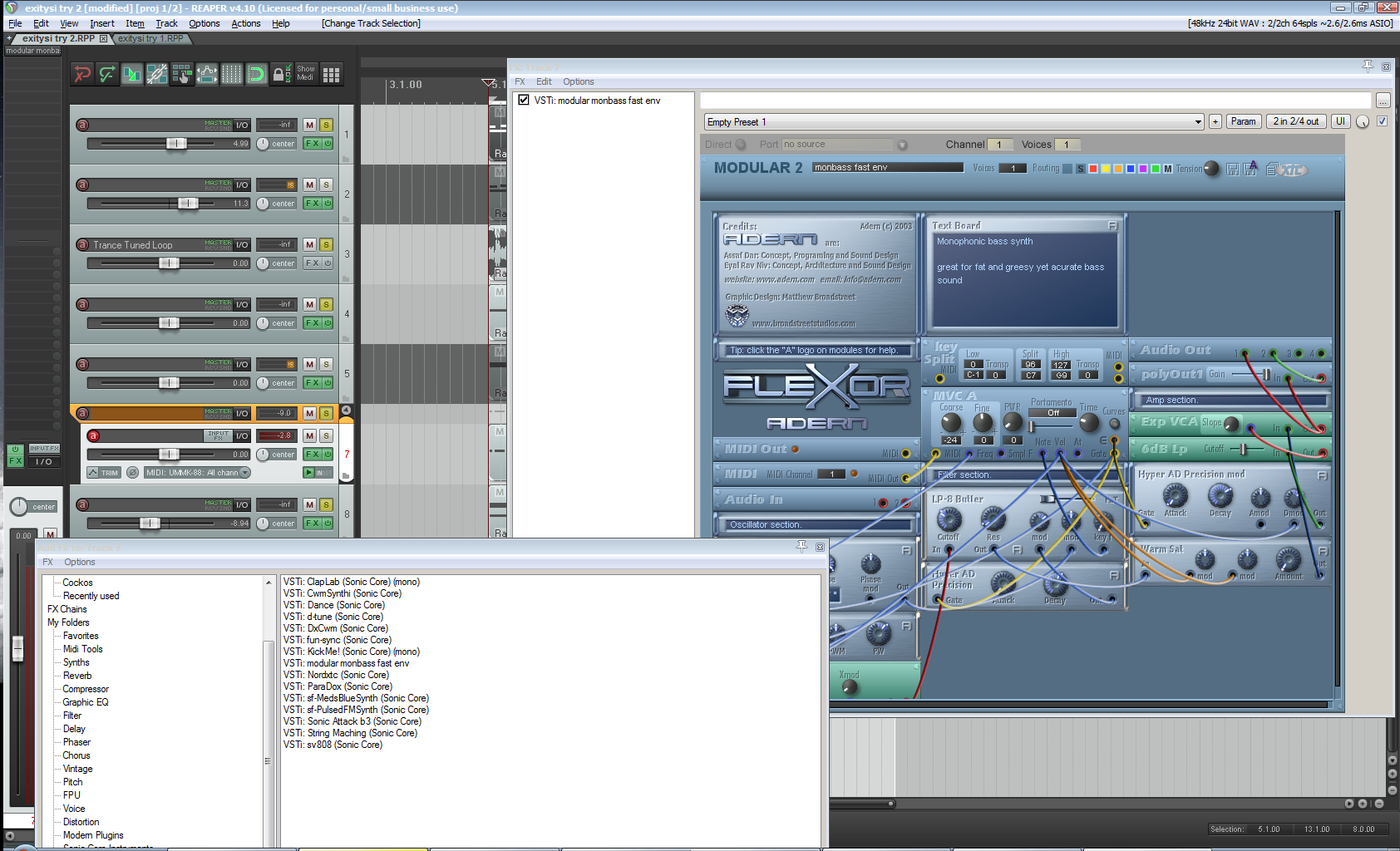

@garyb
why mod not working in xtc ... here it runs
any problems i didn't discovered right now ?
i didnt run xtc mode often but sometimes its a nice and easy way to work
- mod.png (564.72 KiB) Viewed 5369 times
lg widy

actually, xtc mode is not supported for anything. it was abandoned in v4. since so many like it, it's been retained, but i don't think that there are resources needed to implement it as people would like. yes, mod will work. afaik, it's a little buggy as you report, but i don't expect an explosion or anything.
the wave driver issue in 64bit is much more important.
one thing that might really help, be sure that Cubase is running "as administrator" if you are using xtc mode and that Scope is running "as administrator" in Scope mode. many strange errors disappear that way, just in case you aren't doing this.
