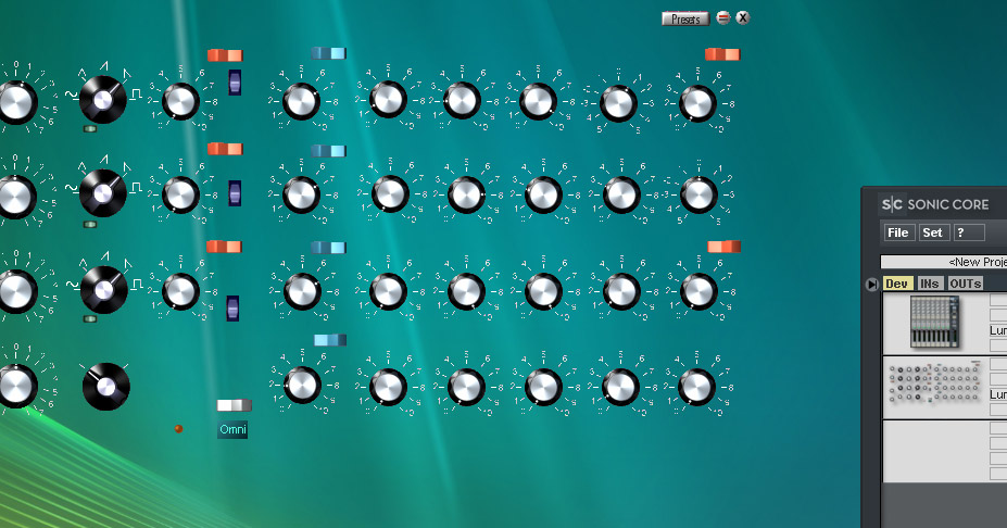

2.) Miniscope MKII opens without background, only control elements show on screen. So I can confirm a previous post in this thread.
