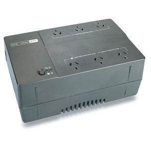

Well apparantly I can get this from Dick Smith $129
POWERWARE 500VA
POWERWARE 500VA
Supposed to last 43 minutes and has 6 outlets.
I always thought they were more expensive than this unless this one is el cheapo & crappy

Well I got the 700VA powerware model
http://powerquality.eaton.com/Australia ... .asp?CX=22
It doesn't say anything about filtering so hopefully it does the job. I only have the DAW on the UPS / Surge outlets, with some of the other gear on the Surge only side.
Should be enough to ride out a 2 second outage though, which is what happened last time.
