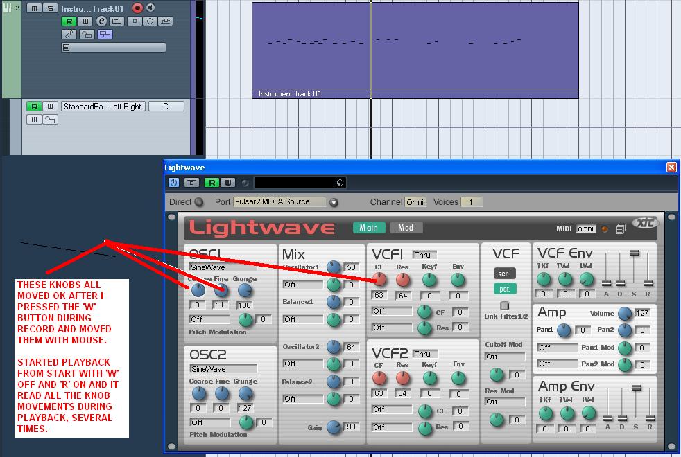

Well it seems to be working on mine, some of the Scope devices dont load - LightWave 5 gives an error, so this is just normal LightWave.
LightWave XTC Automated
Ive got one automation track and its recorded the movement of 3 knobs on the lightwave.
Also not sure why Ive got Scope-PCI as well as XTC synths on the menu - aren't they the same thing ?

Its definately buggy. My results with Poison and Prisma were not as successfull as with Lightwave ( although the Lightwave test was only 5 knobs ). Observations :
1) Poison. A few of the knobs worked, and sliders didnt. When I dropped down the Poison Parameter list, the sliders didnt seem to be present.
2) Prisma. 3 out of 4 knobs I tried didnt automate. However, the parameters that didnt automate were actually present in the dropdown parameter list for Prisma.
3) The above observations hold true whether I was using the mouse or external MIDI controller.
4) I was able to record midi controller info from my Phatboy for any control I wanted, and it played back and twisted the knobs accordingly.
So with 1) I thought I had hit on a pattern that Cubase wasnt automating parameters that were not available to it from the dropdown, but this was not born out by 2) which wouldnt automate even if they were in the list.
4) would be my workaround if I was stuck with this scenario - eg just record the midi CC data rather than record automation tracks.
Hope this clarifies. Probably maybe not what you wanted to hear though :(

stardust wrote:*
In case one moves a knob while having write activated nothing gets recorded to Cubase VST automation.
I have this everyday in cubase 5.5.1.... and it's one of numerous bugs that look like will remain unfixed until a paying upgrade...
The solution (at least with "regular " parameters such as channels or vstis):
- save the song,
- the automation track should appear now.
- stupid isn't it :-)
So not having any recorded automation line is "normal" in 5.5.+..75% of the cases (i mostly automate levels and mutes, shouldn't be a big deal, but...).
i discovered that the recorded automation line appears, and is actually playing, only after a "save" or "save as" of the project. You can try to write all day again and again, it will not do anything until you save. There are a lot of those small bugs that did not exist in 5.1 (the best/most stable cubase ever in my opinion).
saving incrementally and often is more useful than ever with this cubase release...
let us know if the "save" solution for automation works for xtc too.
for the other bugs, i don't use xtc at all so cannot comment.
