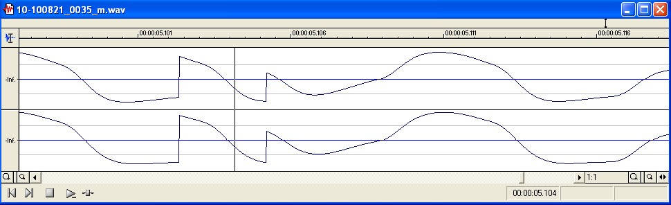

Re: Asio Clicks when receiving midi controller data
Daniel, maybe if U post a little excerpt of the type of noise in MP3, we could help.

Hi again
Here is a mp3-file of me playing a note on the Minimax repeatedly and moving the modwheel at the same time.
Also attached you can see a close-up waveform of one of the clicks..
I hope this helps to clarify the problem.
best regards
Daniel
best regards
Daniel
