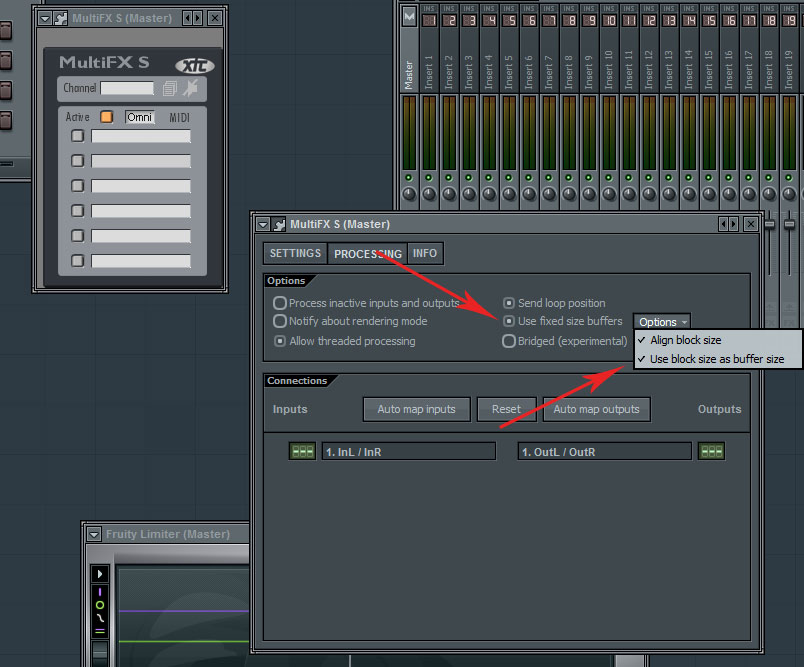

FL Studio is having some major problems WITH FL Studio wrapper and DSP solutions overall(i wonder which version of wrapper you have?). Wrapper is basically their solution to wrap VST effects and instruments inside FL Studio. andsometimes you have to use "fixed size buffers" option inside FL Studio wrapper to make anything DSP (uad, duende etc.) working normally.

I am happy to inform you that XTC but in FL Studio is fixed. There is new wrapper at ImageLine forum which fixed all issues with Scope XTC and FL Studio. After so many testing and posting results issue is finally gone forever. Wrapper is created for public beta FL Studio 9.5 - if you don't have it yet then you should download latest FL Studio and be sure to install this wrapper version. Note that this wrapper will be included in real official FL Studio 9.5 so you don0t have to worry about it.
To work properly you need to have fixed size buffers enabled and ticked "use block size as buffer size". Also make sure that you enable fully automatic plugin delay compensation(part of new FL 9.5 mixer) and you are set.
