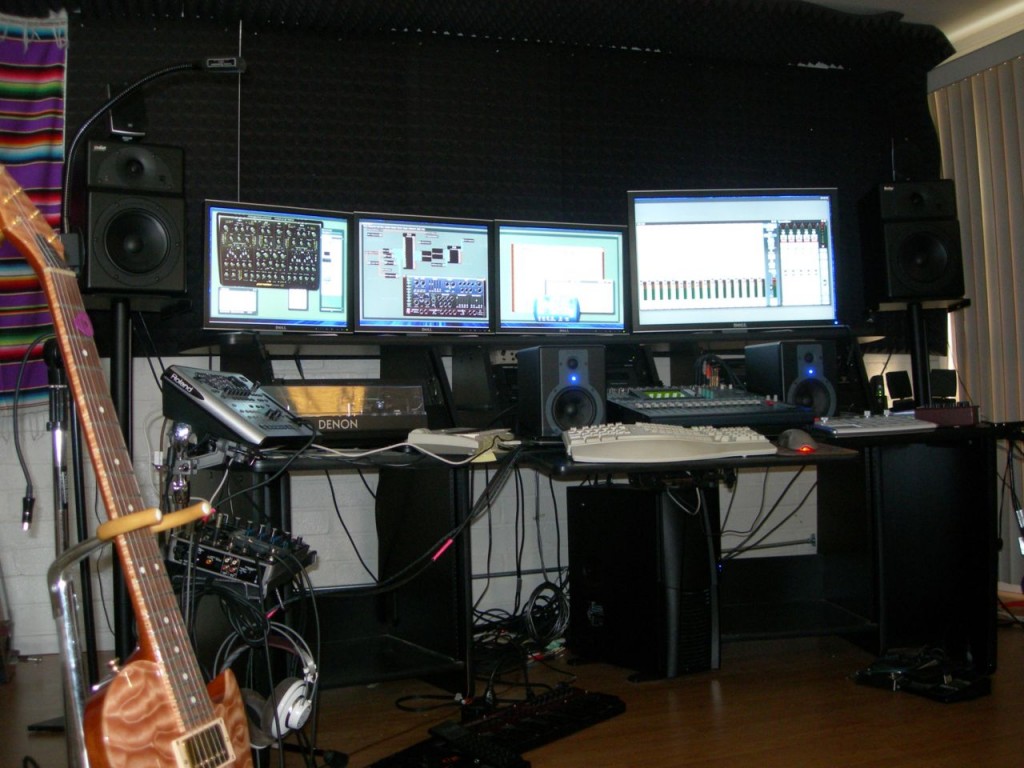

w_ellis wrote:Anyone using the Matrox Triple Head to Go?
Yes, I've been using Matrox TH2G for years now.
Great boxes.
I've set things up using the old VGA (Nvidia card) to the TH2G, which drives 3 monitors off the one port, which this leaves the DVI output for a 4th monitor.
The TH2G doesn't require much extra overhead on the system, since it basically spans one monitor across 3 screens.
It's crazy having 3 screens, but it makes it so easy to see everything without having to sit on top of the computer. :wink:

Wow, lookin' sexy there :)
This is why I need me some more monitor action!
