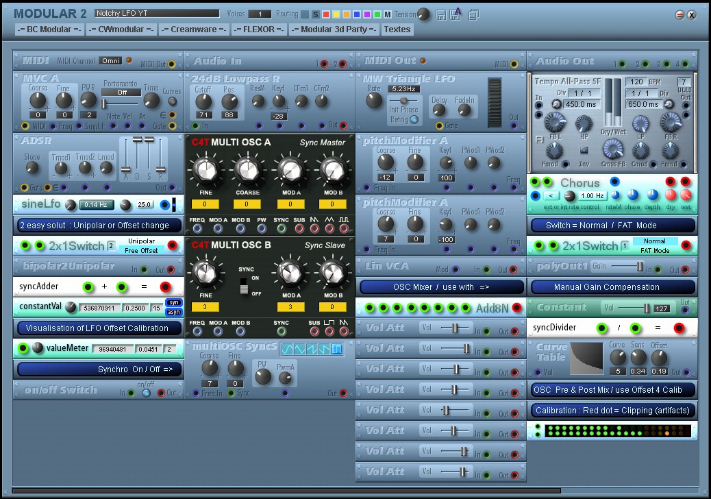

Hi Jimmy,
can you post us a picture of the part of your patch with just the way you want the envelope and LFO are wired and react.
I have several solutions but I don't know which one suits you best for your problem.
YT
YT

Re: Notchy LFO's
Hi Brother Jimmy
I'll post a patch with 2 very basics solutions 4 the LFO.
For artifacts, it is normal because there is no real standard mix in modular, all are incomplete.....
you don't need a limiter because with this you just reduce the amplitude of your signal but not artifacts, you must prevent artifacts but when they are here .......they are here ........
I've added one of my tricks to get a big Fat sound even with only 1 oscillator and without clipping
I don't understand why you say that you can not add other oscillators???
(as you know my english is a little bit ....
If that do not the job like you want, i have other solution in mind (it's just a first tiny test...)
See you soon
YT
See you soon
YT

Re: Notchy LFO's
Thank you Jimmy
I hope the patch resolve your problem, I changed the MVC and the Filter because I don't have Mod IV (in fact i don't have SFP 5).
I'm just inspired by the picture of the post but if you look very carefully your pic, you'll realize yourself very quickly that missing 2 or 3 things .....
WIRING !!!!!!!!
I don't have mod IV, i can't open your patch ......... and with no wiring is a little hard
I just wired a patch logically with the modules that your image offered me .............. done in 20 minutes, 2 or 3 chords on the piano and posted on Z
If you have questions PM me
YT
WIRING !!!!!!!!
YT
