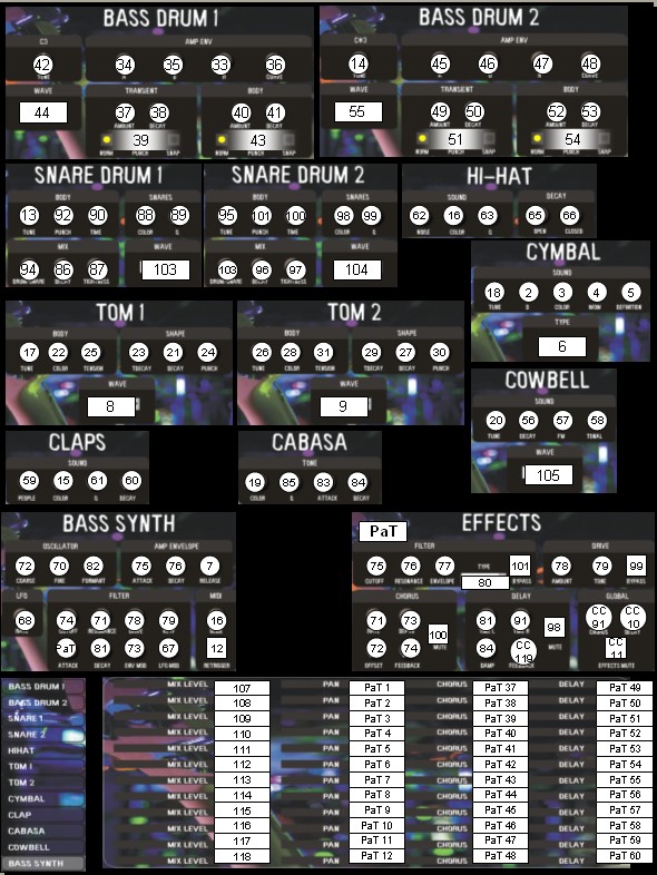

HUROLURA
Posts: 1314
Location: FRANCE
Re: Plugiator Dev MidiCC sheet for Doepfer Drehbank or similar
Post by HUROLURA »
OK here is the Drum'N'Bass
Plugiator Drum'N'Bass CC+PaT midi map
CheerZ
