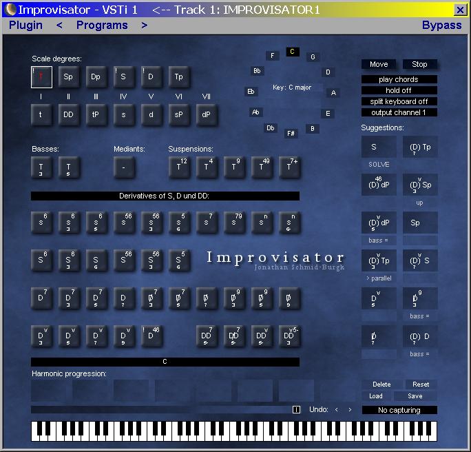

Some other nifty programs out there that are great tools that could be emulated in Scope:
Yeah, should be no more need for anymore hardware
I also have a padKontrol, which serves multiple functions from controller to drum trigger.
- Good for some rhythmic/harmonic developments. (Only really works with external controller - not working inside the host)
- 7Aliens_HarmonizerW2.JPG (59.37 KiB) Viewed 2062 times
- Handy for coming up with some great chord progressions.
- Improvisator.JPG (74.24 KiB) Viewed 2062 times
