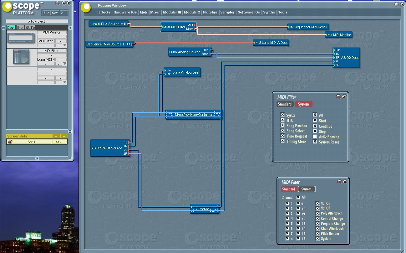

My PC Freezes from Time to Time with Soundloops.My System is in XTC-Mode.
I tried to Filter "Active Sensing" with the Midi-Filter.And after saving my XTCProject.pro in SFP-Mode, I started Cubase SX3 in XTC-Mode again, but there is no Midi Signals.
Here are the Pic of my XTC Settings
Trying to kill Active Sensing.jpg (512.21 KiB) Viewed 774 times
Another way I read in other Threads was to Kill Active Sensing inside of Cubase SX3, But How?

you're not using the filter properly, it's opposite, but it should work. as i remember, xtc users seem to like the driver from v3.1b best...i think it's posted here on pz.

garyb wrote:you're not using the filter properly, it's opposite, but it should work. as i remember, xtc users seem to like the driver from v3.1b best...i think it's posted here on pz.
:) Thank you garyb. Great it works. With an Antique Driver :o and without Filtering "Active Sensing"

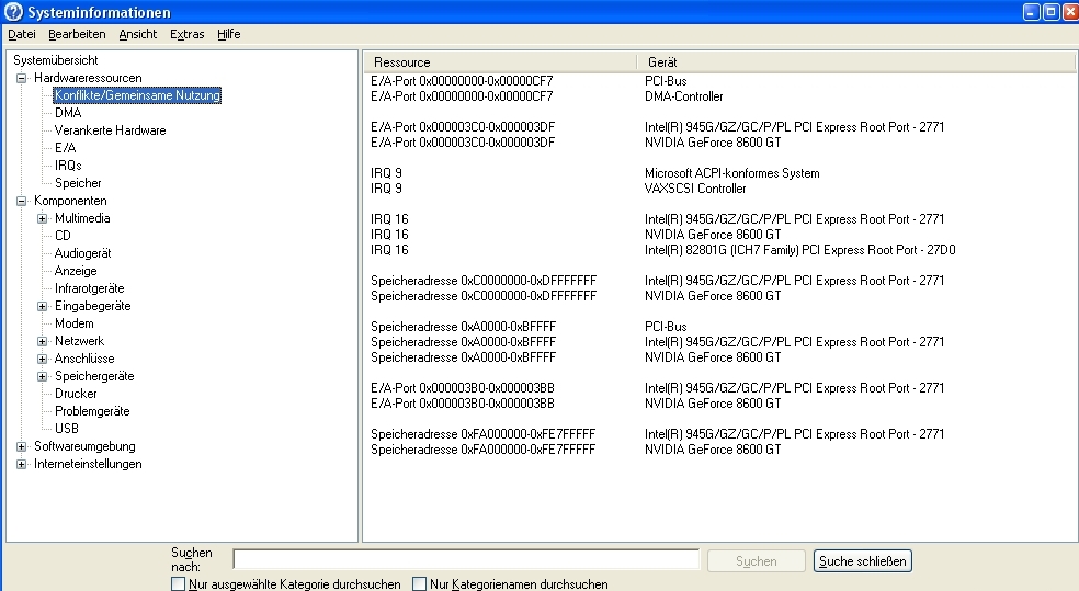

I have a second Question about Irq Problems: Is it possible to solve (Optimize) some problems in this Picture? (But its not possible to change the Pci-e Slot of my Graphic-Card)

about the irqs, they look fine. i'd leave it alone.
