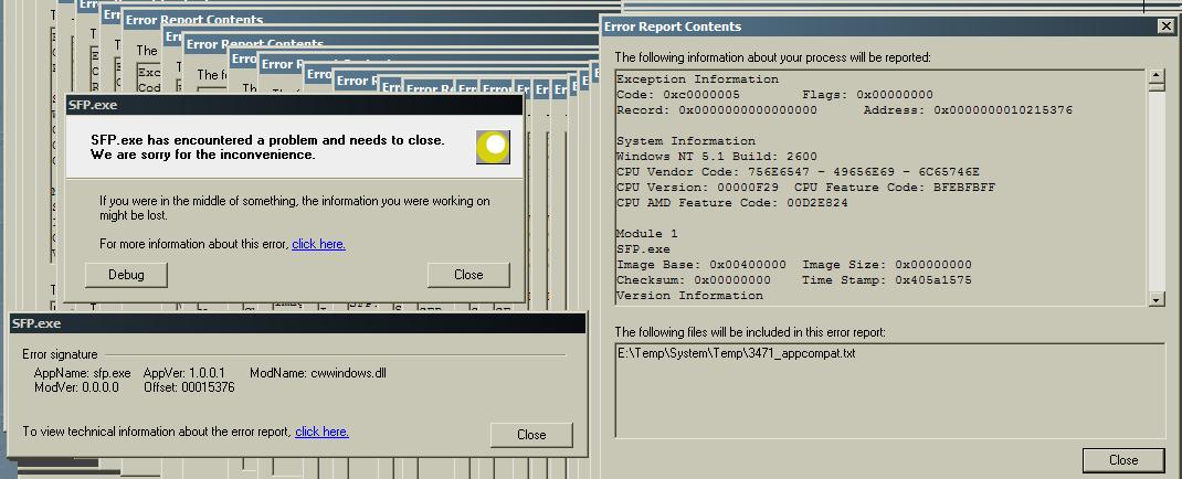

See image for error message. I also get this error in Scope 4.5.
- Scope Crash.JPG (81.46 KiB) Viewed 1640 times

Start simple, backup existing projects and your keyfile(s) plus a copy of both cset.ini & scope.rgy if you haven't already.
Now that that's done, have you installed 3rd party devices (not just modules) that weren't packaged with Scope or in .oxe files? If not then there's something else wrong.
If so I'd suggest a clean install of Scope to see if the problem persists. If Scope runs fine off a fresh install, reinstall things one by one paying careful attention to when the error appears, and hopefully you'll find the problem.

Well this is a blast from the past. Well i can say i still have this problem - i tested just Modular patches without FleXor and the same thing happens. However to achieve complete Scope death i have to load and unload many Mod patches. Of course if i'm trying out a few to find a sound i like then this will happen a lot. i think last time i did this it completely closed Scope, but at least my computer doesn't decide to power off now. i have never had those splash screens you get though, it just closes Scope completely. Easy enough to restart but of course my sequencer loses its ASIO and goes mad.
So no, not fixed. i am hoping that Scope 5 may finally address the ModIII bugs.
btw there is NO difference between Scope 4.0 and 4.5 operationally, there are just more devices in the 4.5 package, drivers etc. are all the same.
