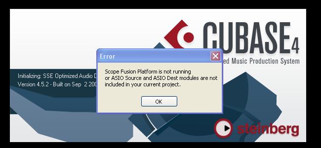

Yesterday XTC did work fine....today i got this message ( see the picture......)
Does anybody have a clue...???

And by the way ...İ did check the option " enable XTC "......

Yes İ did.....but it worked for a long time very stable its suddenly not working anymore.....

Thanks for the tip but didnt work....its frustrating......cannonball wrote:hi

I've got this problem just now... I didn't change or install anything. XTC mode was working fine yesterday, and for several months up until this afternoon. I launched Cubase 5 and the XTC app won't launch. I can't figure out how to repair it. Is there a solution other than the ones discussed here?

Check your Asio settings in Cubase. When theres no Asio to choose. Close Cubase- Open Scope - Load XTCProject.pro (Its the Default settings of XTC) and look if Asio-Dest & Asio-Source are connected with something. If not, here is something to try that maybe helps:
After all Connectings: Overwrite XTCproject.pro- Close Scope- Open Cubase - Go to Asio Settings in Cubase & Choose Asio (I hope)

I got it working. I have no idea what caused it, but some of my SCOPE files seem to have become corrupt and I lost a load of settings. The only thing I saw that I couldn't restore manually off by heart were the directory settings in SFP, so I just reinstalled the software and that worked. I didn't want to have to install the software again because I was worried I'd lose preferences or project files, but it was OK.
