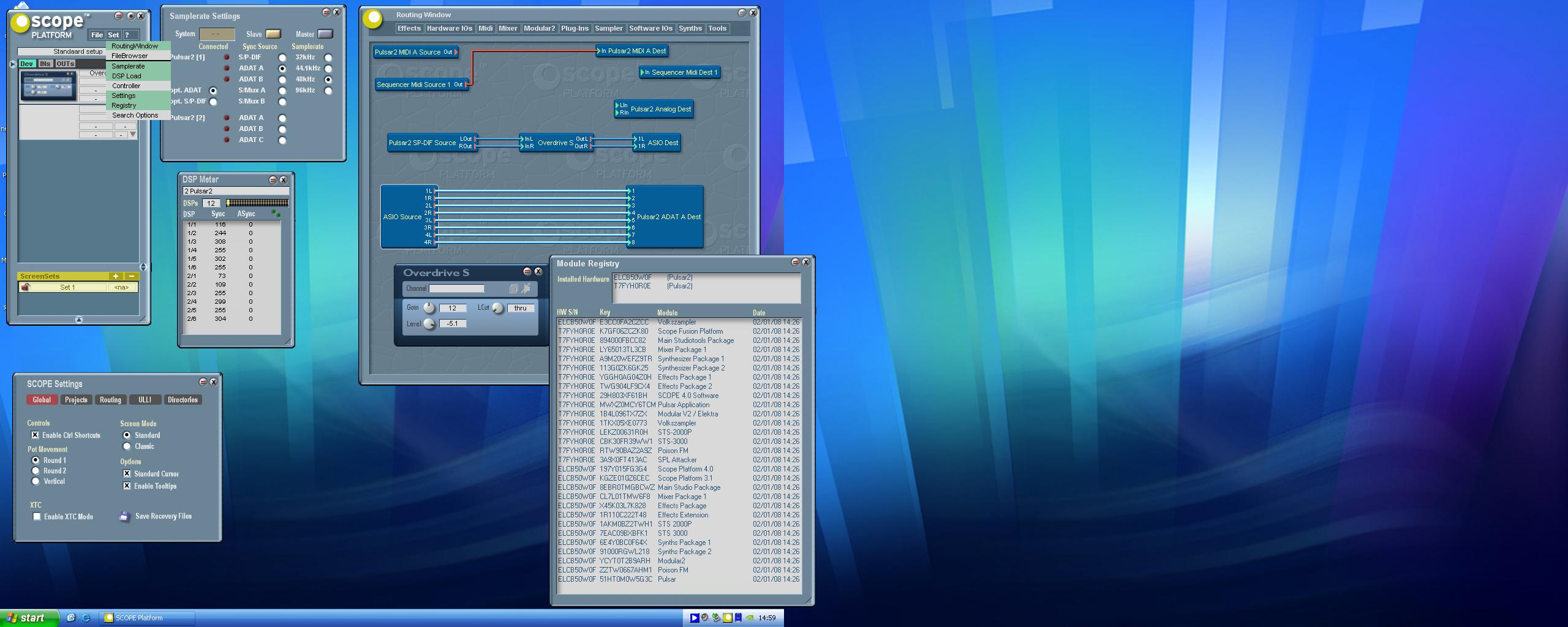

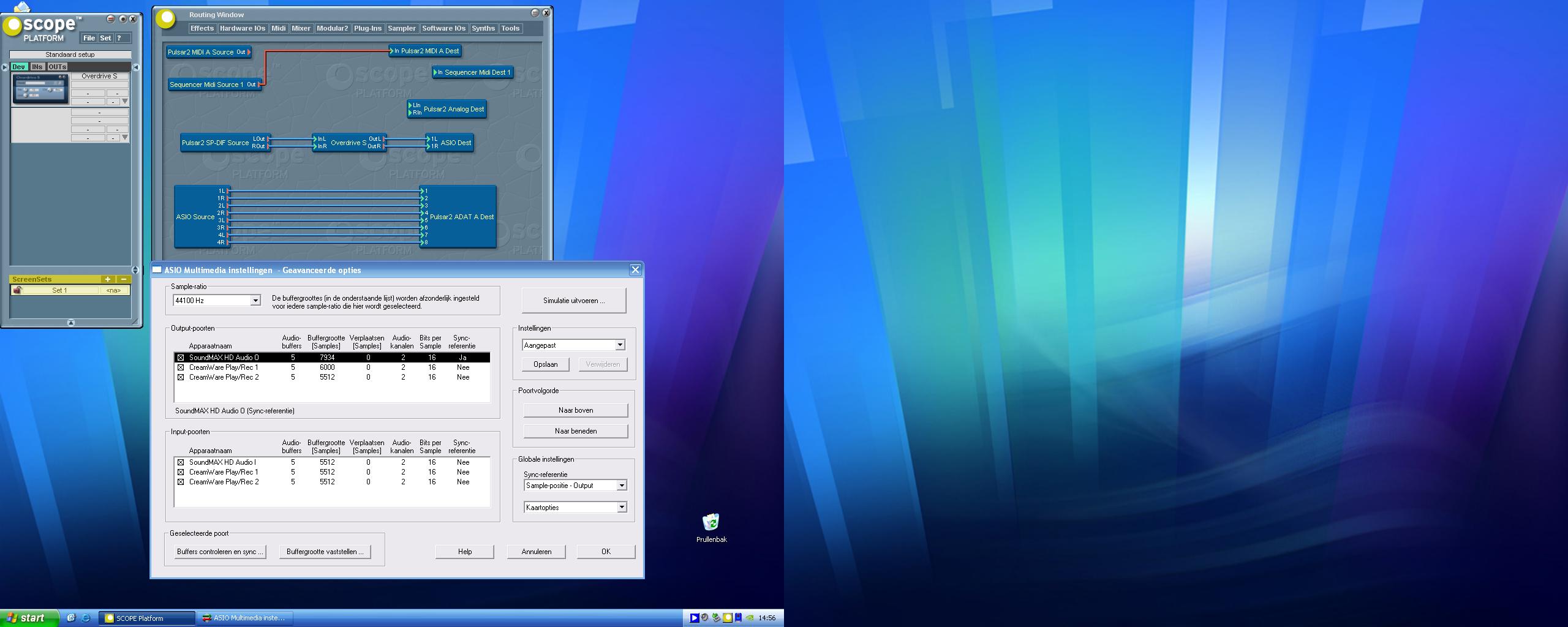

Update: Installed my pc again, all new. installed scope, installed cubase. now i miss 6 outputs. I really don't know what to do. Are the cards broke?
here the Cubase asio setup
scope screen.JPG (209.31 KiB) Viewed 3046 times

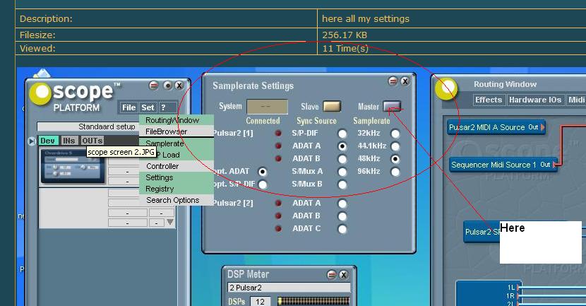

here all my settings
scope screen 2.JPG (256.17 KiB) Viewed 3046 times

Your samplerate should be on master

I have an Behringer DDX3216 which is ADAT master.. i tried..
H-Rave
Posts: 569
Location: Toulouse, France
Post by H-Rave »
well you can see that it's not syncronised can't you so obviously the platform won't make any sound, try it on master

what you see in the asio setup there are the WAVE drivers wich are used to sync the asio there not asio drivers.And I might add that if you don't put wave drivers in your project in to a mixer for example the asio driver can't sync to the scope drivers.you sync the asio setup to the internal soundcard I imagine.
