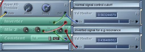

2)u can try a AD Env witch controls a filter freq. and use the same AD R Env signal but inverted to control the Res. use a mixer to shift the signal in the range of 0 to 1 ..see pic
- filter mod.JPG (21.73 KiB) Viewed 2202 times

I switched all modules to single mode and spend a lot of time trying to remove the click of the sine part without loosing its punchy character using the method you described in your post. but had no success. so I desided to use a static LP and I think the result is not so bad at all...
