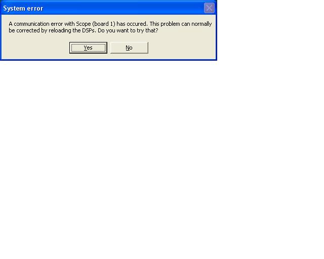

Nowdays I have got a lots of communication errors with my Pulsar2 and SRB (15 DSP) card. I have re-installed the computer a couple of times with same result.
Using both XP SP1 and SP2. Installed as ordinary XP, not as Standard PC.
If I press "...reloading DSP" it continues to load the plug but there is no sound for that plug. Mostly it is PRO-12 which does not work.

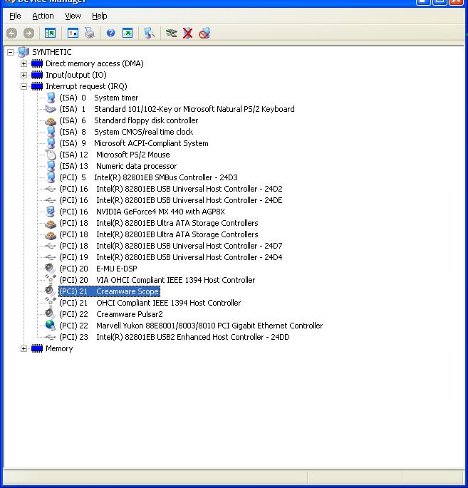

The Device manager telling me that Firewire (IE1394) shares the same IRQ, I have no connected HW to FW but I sometimes use it to my DV-cam.

2. No sharing IRQ with anything... switch off any you arent using

the FW controller shared with scope probably isn't a problem when you're not using fw and scope at the same time, but you'll probably want to move the card to another slot to try and get an unshared irq. there may be other devices to disable such as some of the extra usb controllers, but only if they conflict. the FW that is shared looks like one of 2. if itr is, just disable it and use the other FW port(looks like a FW card as well as a port on the motherboard).
if that message only comes up occasionally, i'd just do the reset and continue. a restart would likely help as well.

Have tried to move the cards with same result, it is ONLY when I try to load PRO-12 I got this error message, strange.
