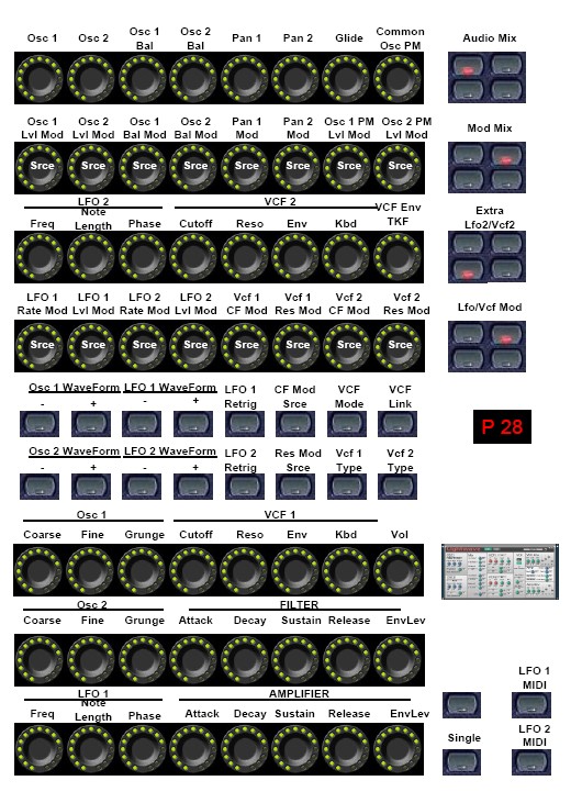

Here is my brandnew template for Noah Lightwave.
The idea was to build it up in the spirit of the MINIMAX, Pro-One or PROFIT 5 mapping.
One thing I notice though: the CC 16 and 22 which should be dedicated to Osc1 and Osc 2 Waveform selection do not work !!!
If anyone knows the trick to correct this (if only possible...)
NB: on the 2nd and 4th set of upper button, turning the pot let you set the depth of a modulation destination while pushing the same pot just switch the source to the next one that would have been available from the source selection menu...

The mapping jpg file
BCR 2000 noah lightwave template.jpg (142.87 KiB) Viewed 3087 times
