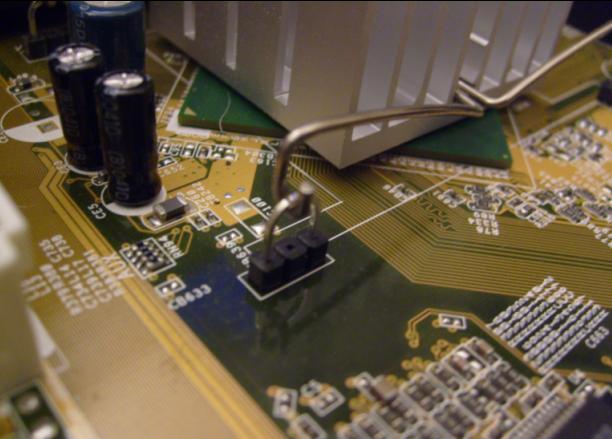

Here is a picture of the handle that broke on the other mobo (the thing with the 3 parts black plastic base) . It was working without the heat sink, but with a scary noise (and it eventually never rebooted for some reason).
Crappy connections: tiny soldering supporting a lot of pressure from the metallic arms

Couldn't you just solder the thingy back on or reattach in a different way?

Counterparts wrote:Blimey, I've never heard of a MOBO *physically* failing before now! Usually something electronic gets fried :-)
My P4B533 had 2 of those:
cpu heatsink bracket was broken a couple of months after i bought it. This kind of failures are not warranty covered; the seller support fixed it by a 'selfblocking wrapper' (don't know the right English word for it, hope you can figure out what i'm talking about)
This summer, atfer 3 + 1/2 years (!), i had one of the handles of the northbridge heatsink desoldered. I was able to notice the trouble just while attaching an HDD to the IDE chain, cause no noise or system alert for that here.
Having a good 10W mini soldering iron and several years of experience in soldering I was able to fix it. Just hope it can last.
Cochise
It was the same part desoldered in my PB533 during llast summer. I noticed it one day on the bottom of the case.
Ehi, nice picture! I can't zoom that close with my cheap camera.

if those handles are fixed by solder only, then I'd consider it a truely crappy construction. Solder is a rather 'elastic' substance and there's constant tension from the spring load applied...
It would be best if the backside of the 'handles' is long enough to be bent together and fixed by solder to add some mechanic resistance.

petal wrote:Couldn't you just solder the thingy back on or reattach in a different way?
I managed to glue one of them, but not the other. Moreover, on the p4pe that I had, there is cuircuitry going just under the plastic base (not on my new p4p800S-X).
In addition, i did bend the metalic arms a bit too much, so there was not enough pressure anyway (and yes, it is only tiny soldering, as much as i could notice, but of a size I cannot do myself... I usually have good result with soldering (ask my preamps :-) but i didn't even think about it with the mobo ).

ps: the picture is made in the "macro" mode of a lousy samsung camera, that i had in exchange of a broken "cheapest" pentax (so i had 1.2 million additional pixel for free 1 year later :-) . both are in the "cheap" range (ie, no stabilizer, wich is a pain in the ass, and a rather pale non sexy result for the samsung, which performs less good - with its 7.2 M pixel - than the 6 M of the pentax with carl zeiss optics. the pentax could go even closer in macro mode).
