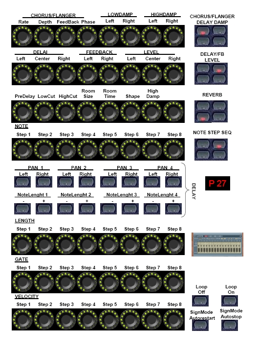

This new BCR 2000 template is just a way to map the control of the first 8 step of the stepseq integrated on the NOAH. I also mapped the main cantrol of the aux effects (chorus/flanger, delai, reverb) on the 3 first top 8 encoders.
The Stepseq control is available on MIDI channel 1.
The aux effects control are available from MIDI channel 16.
As stepseq is controlled through polypressure message, it is possible to use it together with another template to control synth parameters on MIDI channel 1 by either having 2 BCR 2000 units or swihching presets.
A 16 stepseq control would be possible with a second template for controlling step 9 to 16 (I have to think about it...)
Any comments welcome
BCR 2000 noah 8 stepseq+aux templates.jpg (274.32 KiB) Viewed 2979 times
