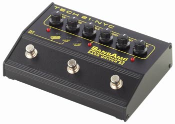

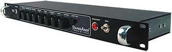

i use this one for bass guitar, means direct, no mic, fantastic sound:
http://www.thomann.de/gb/tech_21_sansam ... preamp.htm
and if you're looking for some presets for live use, take a look at this:
http://www.thomann.de/gb/tech_21_progr_ ... ver_di.htm

Brotha' Man Katano,
I have heard that the Tech 21 was good. Thanks 4 remonding me as this is to be investigated thoroughly.
