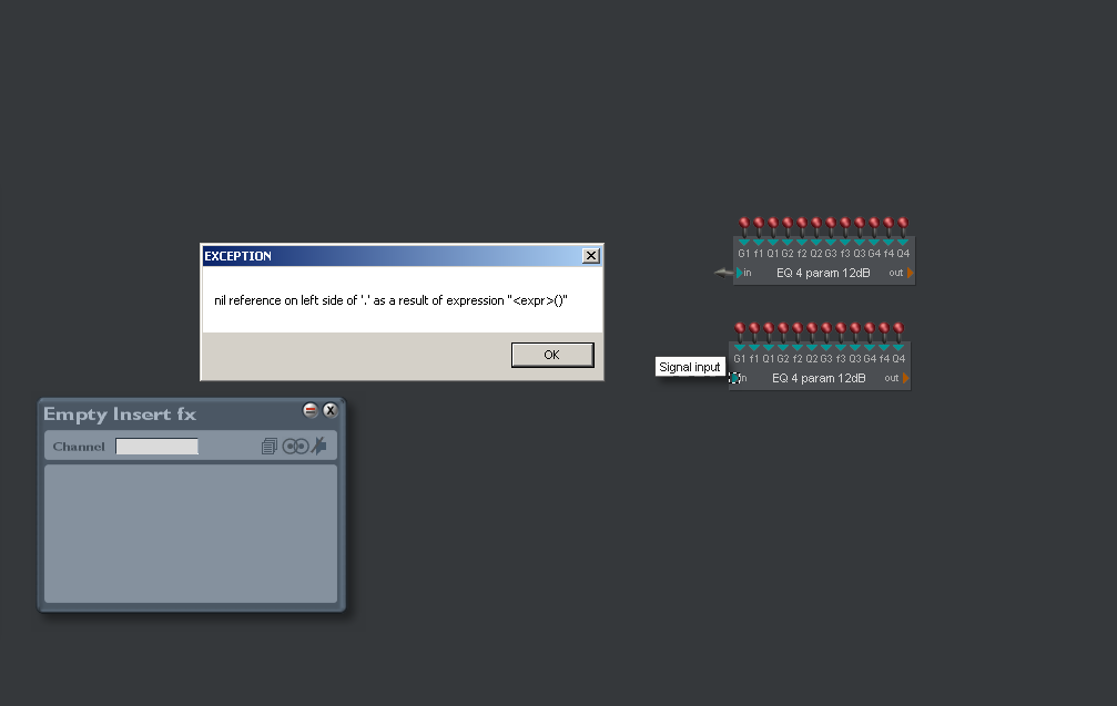

The only difference I came accross yet, was a requester when exporting from folded view. It appears when I try to get the export menu.
As export works anyway, I ignored it.
for this, I confess I don't know / am not sure . I would need to experience it to be sure. In general it is related to graphics saved in the wrong way, or something that has not been made correctly (for example, saving part of a graphic group that should not be saved that way). In very rare cases, it may work but may contain a bug that reveals itself annoyting later. But I do not know for sure.
By "export" do you mean "saving" ? the term "export" is particular to pads that you "export" ie make visible and connectable on the upper level.

The export-menu with that requester was the "Export Pad" in the folded view. If i call the same menu now, no error requester shows up and it looks like in the video. So my journey can continue :)

Ah yes, the export is in the context menu, right... got confused too :-)
