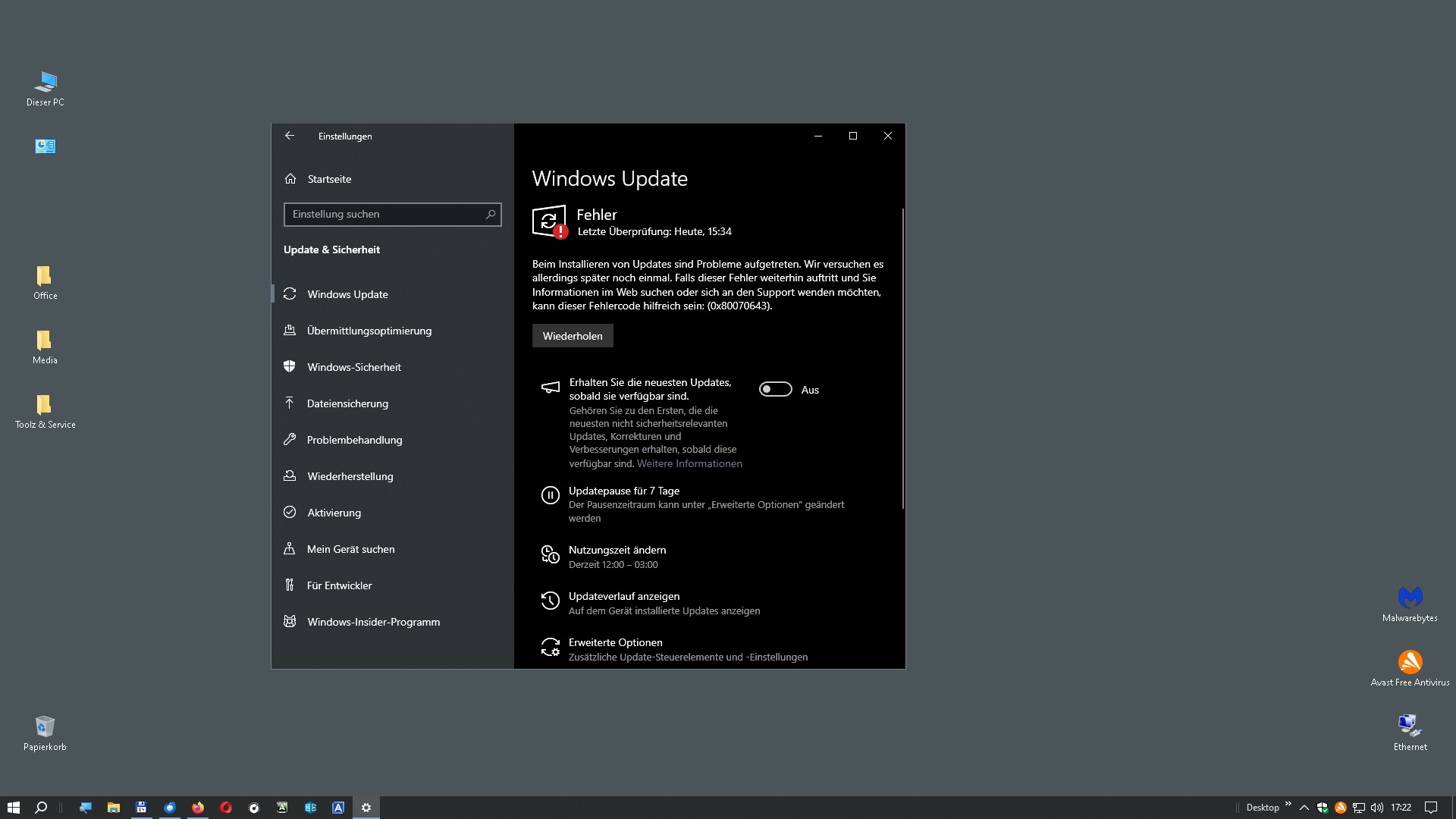

Well, I got this message and tried everything I´ve found in the web according this Windows update failure and a fix,- but no change.
Win10 Pro 22H2 update error code 0x80070643 .jpg (187.93 KiB) Viewed 60315 times
Am I the only one ?
Error code: 0x80070643
Any idea?
Is it possibly Win Privacy or OOshutup10 related ?
It´s the 1st time Win10 security update doesn´t work here,- laptop and desktop machine.

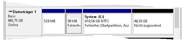

Which partition/volume to shrink ?
Win10 Pro x64_system drive.PNG (6.85 KiB) Viewed 59767 times
On my machine, "diskpart" lists the 529MB partition #1 on drive #1 as "WinRE" (recovery partition).
Partition #2 is the 99MB partition called "system" ... but then there is an additional one,--
Partition #3 (16MB "reserved") not visible in the pic above.
Partition #4 (418.56 GB) is what is shown as partition #3 in the pic above,- and in "diskpart", it´s NOT called "system",- but IMO, that´s the partition w/ the Windows OS,- no ?
The last (unallocated) partition in the pic above is not been listed in "diskpart" at all.
It´s "SSD overprovisioning"
So,- the 418.56 GB partition is the one to shrink and the 529MB partition is the one to be extended?
What about the 99MB and invisible 16MB partitions?
Do they move?
What happens to the data in all these partitions except the WinRE which has to be deleted and re-created?
And, when I followed your instructions, somewhere I got the message "no drive selected" (no partition selected).
Now I wonder if the commands "select disk n" and "select partition n" (n = number of disk/partition) are missing in your step-by-step advise above.
This,- because "run sel disk<OS disk index>" and "run sel part<OS partition index>" just only open the disk and partition indexes,- but doesn´t select the OS drive and desired partition.
The same might happen when you "run sel part<WinRE partition index>".
But I had to exit before not making a mistake, so for the latter I dunno.

Yes it looks like your recovery partition is at the start of the drive. Let me respond later, on mobile now.
Posts: 7760
Re: Win 10 Pro update KB5034441 (Windows RE update) fails with ERROR 0x80070643
I'm not really sure what to recommend here, all of my windows machines have a start partition that is actually the boot partition. Can you show me the output in DISKPART and not just the windows Disk Management utility?
Run CMD.exe and type: DISKPART (if your command prompt is not elevated, this will prompt you to start DISKPART in a new elevated prompt window).
SELECT DISK N (where N= the # of the drive with the windows partition, DISKPART and Disk Management (win utility app) generally use the same numbering scheme)
LIST PARTITION
This should also now show you the initial SYSTEM partition, as well as a "Reserved" partition right after that which likely comes before your "Recovery" partition.
Paste the screenshot here like this:

I followed the exact steps in your third post, and it works!
Thanks Valis
