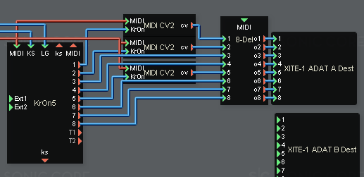

8-DEL FOR KRON
Adds latency to one or several ADAT Channels to compensate the latency of the Midi to CV signal (if you use the device "Midi to CV").
• In general, you add latency to all channels except PITCH signals: you want to delay the modulations so they match the latency of the PITCH.

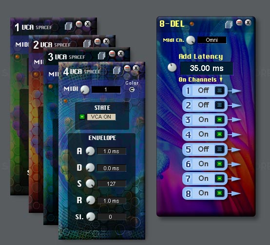

1-2-3-4 VCA
This device is an MIDI envelope generator allowing to shut down the sound of KrOn when you stop your DAW.
In general, you use it;
• on the same midi channel as KrOn,
• OR on a different midi channel playing the same as KrOn but on a different midi latency setting (in your DAW).
• OR standalone without any track latency, to add an envelope to any sound.
In general, this device is used with a latency of Zero, while KrOn is used with a latency of “-xx “ ms (-xx is the negative value of the latency applied to KrOn with the 8-Del device).
It is also possible to simulate latency compensation by adding a little bit of Attack Time to the envelope. This does not create latency but allows to hide a picth latency/portamento effect. This probably depends on the type of sequence you are playing, because you add some attack time that may not be desired, but it is generally acceptable and works fine.

8-Del :
• Delay around 30/40 ms on all channels except the ones carrying a Midi to CV PITCH signal.
• KrOn Midi track in DAW: track latency of -30/-40 ms (the negative value of the delay time set on 8-Del device.
VCA
In the DAW:
• copy the KrOn midi track on a new midi track
• Change the midi channel (eg: midi=CH:2 if KrOn is on CH:1)
• Midi track latency of zero ms (or the negative value of your ulli settings, such as -3ms , -7 ms etc).
