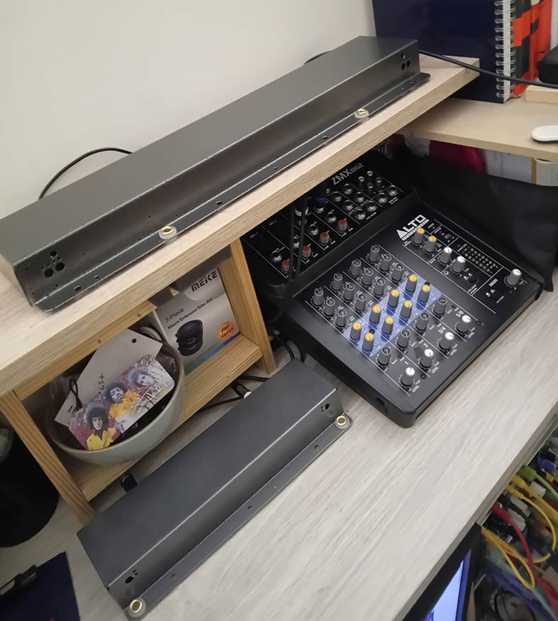

				Ok, at last, 1 year later,  here is my rig for a Spring reverb on line outputs.
One can use headphone output of Xite to send directly to a spring reverb,
Here are two YT tutorials about that:
https://www.youtube.com/watch?v=CXJdSREWxxY
https://www.youtube.com/watch?v=vIryyi3bp-c&t=1s
but I need the headphones out, to use headphones, so I needed to use Line I/Os to save the headphones out.
Problem: headphone amplifiers are not made to be plugged on Line outs (they just extend the headphones output). So it is useless if one needs to use Line i/os (except more expensive models probably).
- I got a second hand mixtable (alto ZMX862) with most outputs @ 120 ohms, including headphone output. So it is like a headphone amplifier with extra functions. I can feed it with line level signals (you can't do that with headphone amplifiers).
- The Spring is BB type ( 150/190 Ohms input /// 2575 ohm output)
- The Spring goes to a HiZ input of Xite with RCA to TS cable.
cost: 40 € second hand mixtable + 30 € spring (NEW) + 18.50 DHL + 9.99 2*RCA to TS" cables =

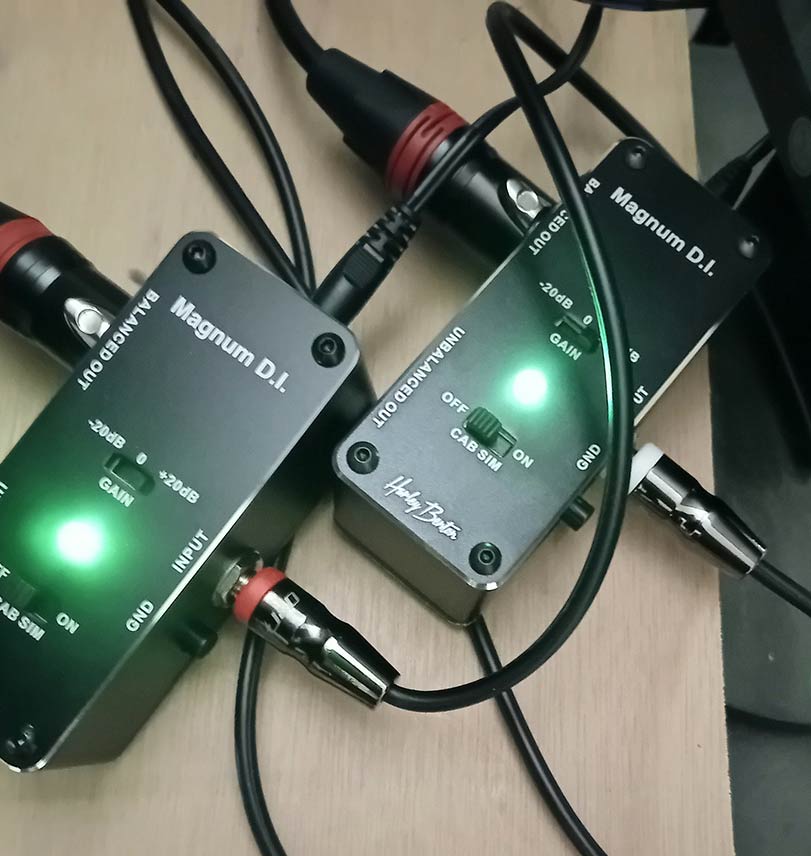

				I just received and tested the Harley Bento DI Box, and it works fine with +20dB switch (on the pedal) and XLR to TRS to A16 ultra. Otherwise sound is weak (I guess one could use a 24dB gain if TS input is the only input available).
Well, I suppose it is normal, it is not a mic/hiz preamp
I am glad to have been able to free one mic/hiZ input to keep it for microphone (I don't like to plug/unplug cables on Xite... I would not like to break them).
Pfeew, I am glad to have finished this setup.

-> Tank output 2500/2600 ohm = goes to hiZ inputs or through a 20/30 € DI box (preferably an active guitar pedal with DI output on XLR/TRS, as the passive DI box I tried did not work at all and the TS might not give enough volume to be used straight away).
Of course, deluxe people will have a look at preamps with all kind of inputs and gain.
I also suppose that a mixtable with HiZ inputs will work too to plug the springs and get them back as line signals (but they are expensive).
I recalculated and my setup costed less than 150 € for 2 springs (behringer can't do it apparently, their spring aux effect is 199 € / mono
Anyway, I hope it helps !

				Here are some pics of my final setup.  I also made devices for them fo Scope/Xite, that you can find
here
viewtopic.php?p=356852#p356852
or there
https://spacef-devices.com/free-downloads/
They are Send/Returns tailored for mono effects. Fully tested with the pictured setup
Sounds really great like that...
