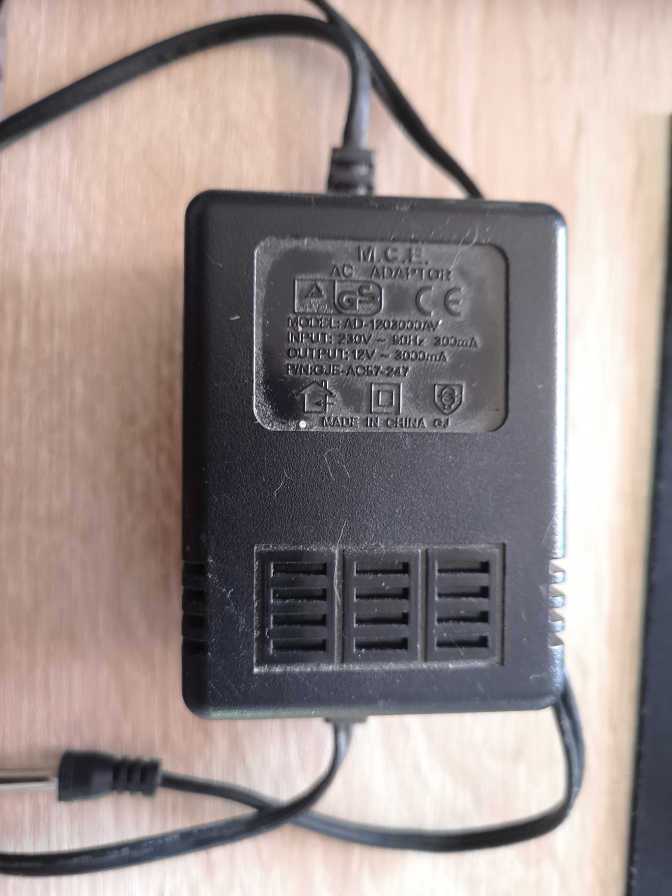

				After checking everything, and before throwing away my A16
As I bought it second hand, is it the original power supply, if not which power supply do you advise me to use?

				that should work, i believe. did you put a meter on it?

				14/15v but not stable

				Strictly East wrote: Thu Apr 16, 2020 2:04 am
... is it the original power supply, if not which power supply do you advise me to use?
Original or not doesn´t matter.
For A16U you need output AC 12V / 1.5A.
For my S|C "blackface" A16U I have  AC 12V 1.6A and for my CW A16U there´s a much more bulky AC 12V / 3.5A.
Both work.

An AC powersupply is just a transformer within an enclosure.
To deliver the required voltage during regular load conditions, the transformer's unloaded output voltage is higher than printed specs because voltage will drop under load.
Considering the current difference the S|C and CW A16Us may have different designs.
With a 'bigger' than required PSU internal voltage regulation will have to work harder, which is not a problem, but it will produce more heat and may age (in particular) capacitors faster.
(this does NOT apply to switching PSUs)
