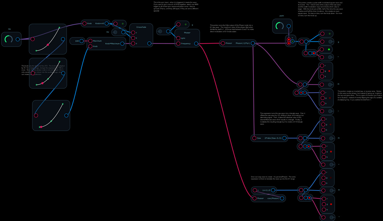

By reading around on Expert Sleepers site about the ES-8 module, I discovered "Audulus", a modular app first for android & ipad (I hate touch screens) and now also for windows. It's a standalone or vst. The standalone interest me : I can setup its audio interface as ES-8. So I'm trying it.
The bad thing seems that everything must be done with mouse ! I prefer jeyboard shorcuts but I can handle with that. And the very very good part is that it comes with a lot of modules ; but one can "enter" in the modules which are build with "atoms" ! For instance, here you have the "basic LFO" inside :
basic lfo.jpg (116.15 KiB) Viewed 7710 times
So, it looks like Scope SDK atoms or Reaktor core level ! That is very interesting for interacting with eurorack via Expert Sleepers modules ! Opening wide possibilities ! And you can see some text field that give infos & explaination all around. All signal are animated in real time, apparently blue = negative, red = positive darker for high values on all wires and inputs.
I guess I'm going to have a lot of fun with that ! And the price is correct : 51.12€ !
