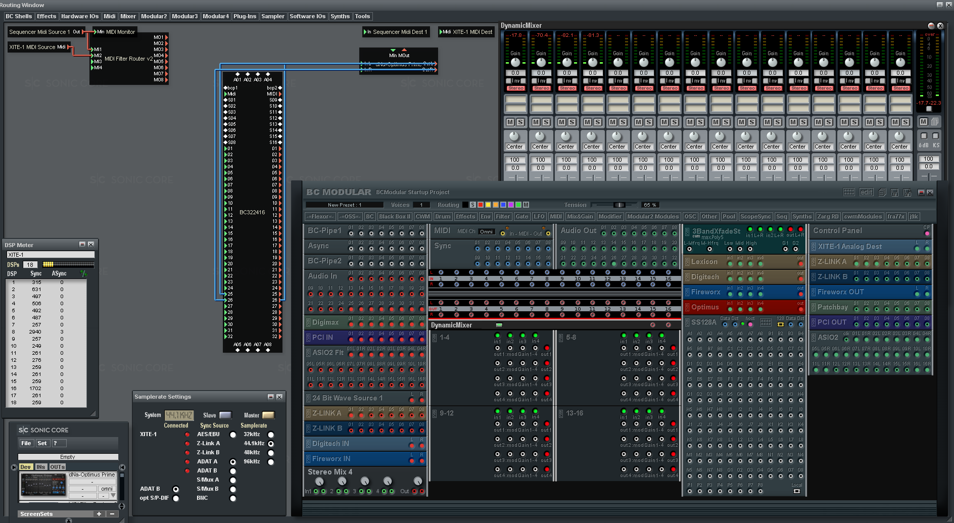

Well Jimmy you inspired me to finish an experiment I have been wanting to do for a long time and that is to fit my complete startup into a BC Modular shell. It uses all of the in's/out's on the Xite-1 minus the headphones out and mic inputs that I only load when necessary.
Features:
16 St CH Modular Dynamic mixer,
ZLink in/out to A16U to patchbay,
ADAT A in/out to Digimax-Ext Mixer,
ADAT B in/out to PCI Computer 26DSP
ASIO out/in
3 Hardware External Aux sends(Lexicon MX200,Ditech GSP2101, TC Electronic Fireworx)
dNa Optimus Prime setup as Aux4 send (Tried using insert effects but ran into SAT overload)
3 open inputs on Dynamic Mixer for synths which will be loaded into the project windows for DSP/SAT purposes
Scope Sync ready!!!
Modular Startup.PNG (333.95 KiB) Viewed 23103 times

Awesome Yayajohn.
BCM is incredible thanks to the Scopers that made it happen.
Re: BC Modular Startup
I made a test and sync i/o can't carry audio signal, finally ! :D I spoke too fast ! It works only inside modular, not to outside... Sorry, Jimmy !
JoPo wrote:I made a test and sync i/o can't carry audio signal, finally ! :D I spoke too fast ! It works only inside modular, not to outside... Sorry, Jimmy !
But still you can get extra inputs.... :)
Mixers using true stereo AUXs or external Master FX external devices make using hardware FX in Scopd a breeze.
Tonight I try RoyTs SC Insert slot with Symetrix Quad Expander/Gate hardware.
If it works a Drum Mix will treated in Scope Modular and spit back out to hardware..
