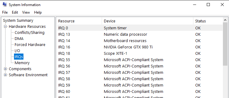

Valis, I've now removed the PCI-cards from the new build and the conflicts/sharing and the IRQs now lok like this:
Conflicts-Sharing ASUS H370 only XITE no SCOPE PCI-cards.png (33.85 KiB) Viewed 25836 times
IRQs ASUS H370 only XITE no SCOPE PCI-cards.png (24.43 KiB) Viewed 25836 times

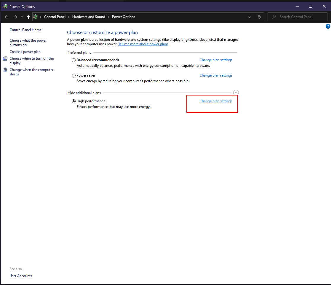

Also of course make sure this is done:
Screenshot 2020-05-09 14.46.55.png (256.93 KiB) Viewed 28875 times
Screenshot 2020-05-09 14.46.59.png (37.49 KiB) Viewed 28875 times
Screenshot 2020-05-09 14.47.03.png (23.51 KiB) Viewed 28875 times
Screenshot 2020-05-09 14.44.33.png (20.55 KiB) Viewed 28875 times
I am sure you know this, but covering it for others later who may read this thread, and just to make sure in your case :)

Posts: 23412
Re: How to optimize windows 10 for Scope to avoid clicks and pops!?
setting power to "high performance" is not really the answer. i use "balanced" and then i disable usb selective suspend and set the minimum and maximum cpu use at maximum. in addition, link state power management is set to "off" in the PCI Express menu.
