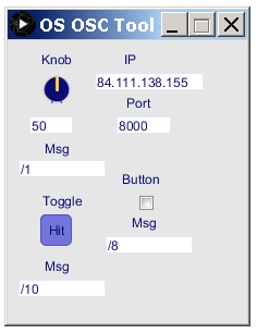

awesome give me 10 minutes ill post here my test tool and a conversion module for scope that takes the integers and converts them to int32 (what scope knobs usually like) :)

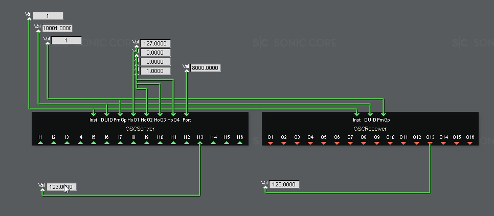

I've just finished the first version of the Sender, which you can find here: Scope DLL
Seems to work inside the SDK. Will be interested if anyone gets time to point the sender outside, especially to a different PC. Note that you can set a different Port + Host per instance of the sender, as there's no problem with having many instances of that (compared to listen ports for receiving).
Here's an animated gif showing it in action!
Let me know if it's not clear what all the parameters mean. I'll probably not be able to do much coding until early Jan, when I get back from Munich.

P.S. I spoke with Faxi over WhatsApp and clarified that you can pass full int32 values over the OSC messages, so no need to scale them. I think that's the best use of the protocol and then scale for display at either end.
