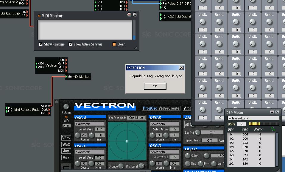

I'm getting error messages everytime I'm clicking on the clear button of midimonitor...
Other strange thing is, the MOut on Midi Remote & -Fader aren't red triangles but white squares?
That midimonitor thingy appears whether the module is connected or not...
scope5 bugs midimonitor.JPG (96.3 KiB) Viewed 4057 times

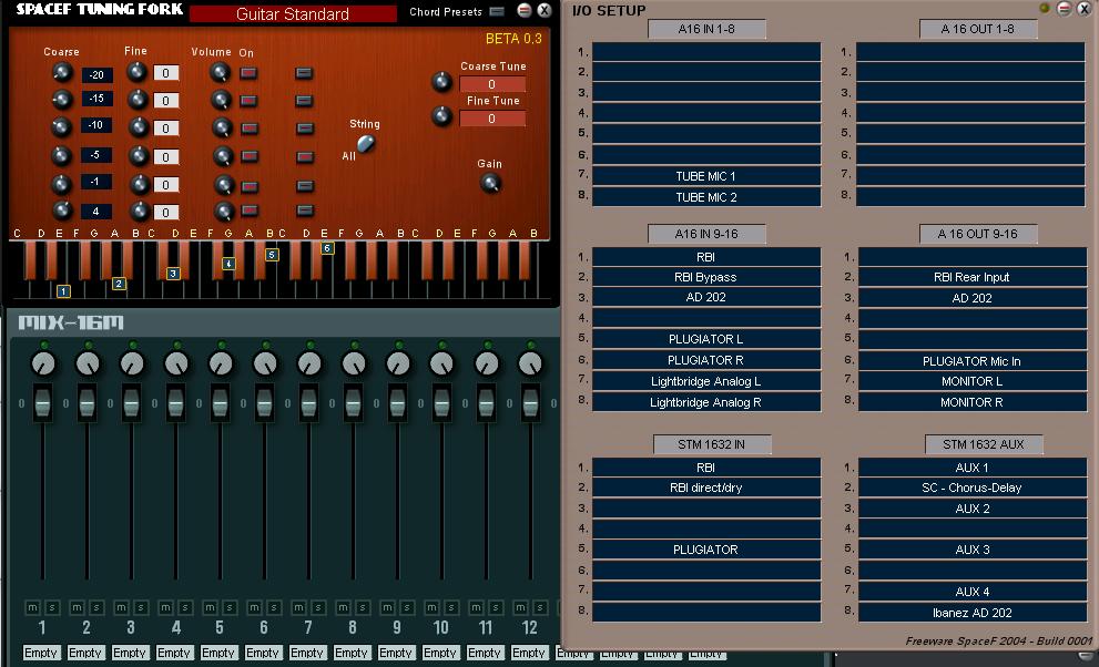

I sometimes have the strange problem that i can't do my routing in the project window...
To solve the problem I have to do routings via the LiveBar or quit scope and reboot. Reloading the project doesn't help.
Then everything is fine again... I really don't know what causes this but it must be something like
loading devices into the project...
I try to use only v5 devices, so far I'm only using space f's notepad and tuner and that cool simple mixer (see below...).
But I don't think it's related to those devices...

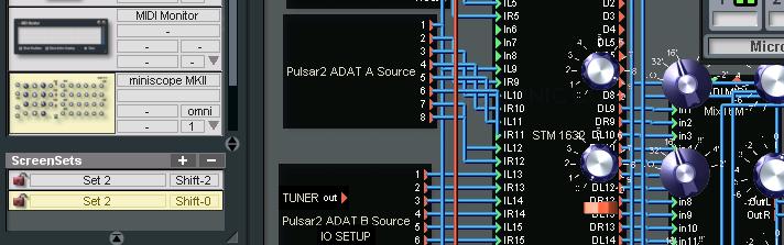

Another little old "bug" is, cabling between STM-Auxes is invisible after Project reload until you click on the connected device.
Anyone else here got those problems?
scope5 bugs old devices.jpg (110.12 KiB) Viewed 3705 times
scope5 bugs kabel1.jpg (7.89 KiB) Viewed 3699 times
scope5 bugs kabel2.jpg (4.87 KiB) Viewed 3701 times

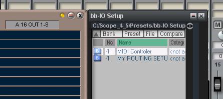

Device IO Setup: i looked for that one recently... i should add preset lists no (unless it is that yellow led at the top right ? )... :-)

Hey Mehdi!
Sorry I didn't make that clearer: Midi Remote & -Fader are Scope v5 devices by SC (really don't know if they existed before) an can be found here:
Tools/External Devices
So: not YOUR bug... :D
And:
scope5 spacef pad.jpg (16.78 KiB) Viewed 3370 times
