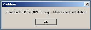

3.) When I open the Circuit Level Module, I get this error:
Any ideas?
Any ideas?
Thanks again,
Ben
Midi thru dsp can be found on the first page of this thread. Just scroll down ;)

Ben Walker wrote:When I open the Circuit Level Module, I get this error:
Any ideas?
irrelevance wrote:Midi thru dsp can be found on the first page of this thread. Just scroll down ;)
That's the one :)
I think I should be able to replace the thru module in there. I'll look into it.
