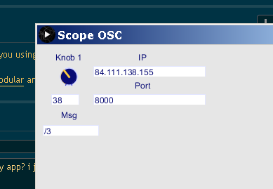

i restarted from scratch on my little app. better code. now i have text fields on the front panel for ip and port, works :)

faxinadu wrote: Thu Dec 21, 2017 6:51 am i restarted from scratch on my little app. better code. now i have text fields on the front panel for ip and port, works :)
Awesome!

oh i didnt notice damn! grabbing now man ty! do you wanna test my app? i just added also the ability to set the message for the knob :)
