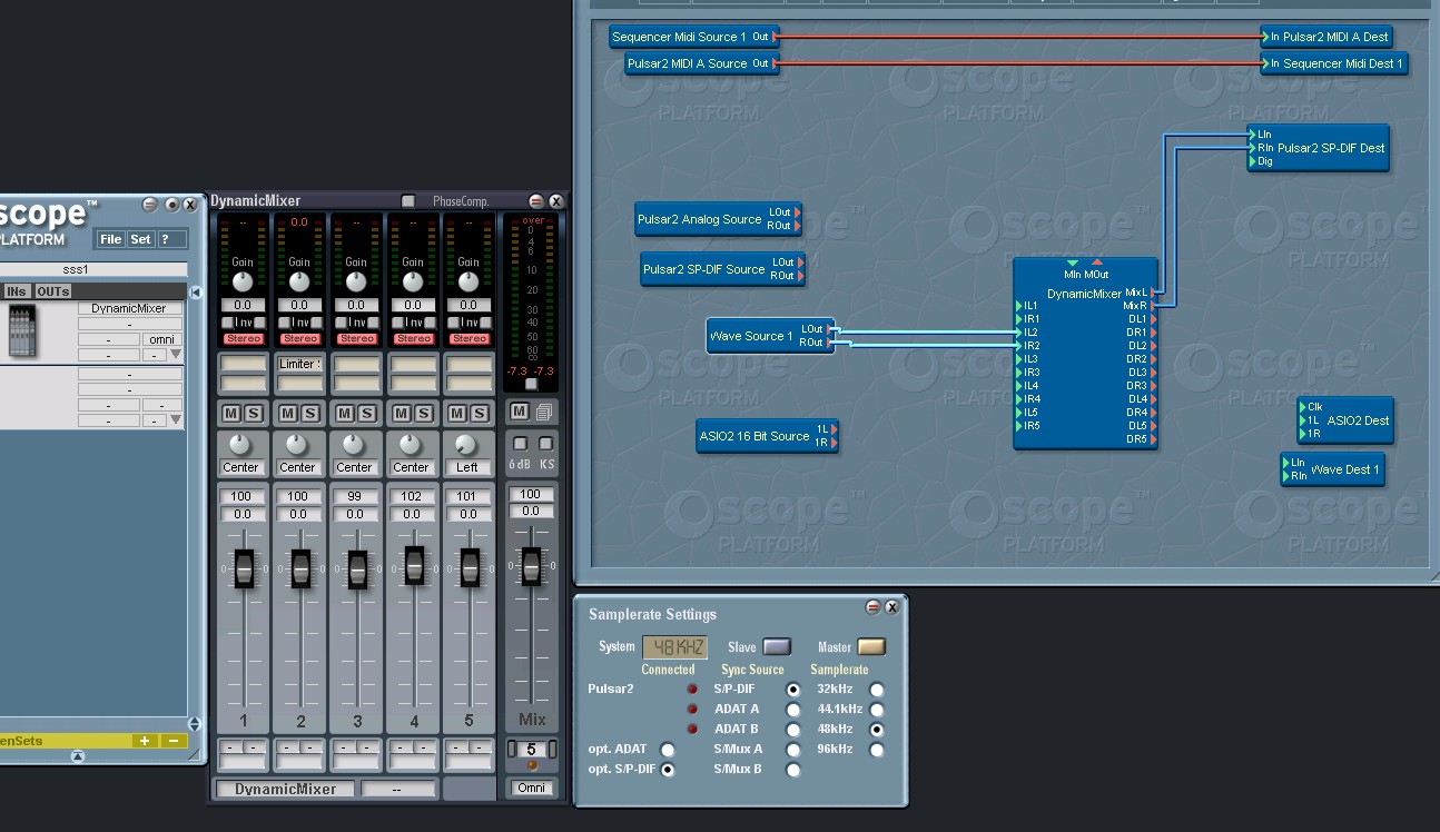

you mean this? if i set like this i hear no sound at all.
						Re: background noise
Yes thats what i mean.The signal is comming from the soundblaster i guess.The soundblaster can output s/pdif and no adat.The connectors look the same but the protocoll is different.if you want to use the adat a port then you should connect the soundbaster via a 75 ohm rca s/pdif cable to the s/pdif input on the cable whip of the scope card.The adat port on the scope card can be s/pdif OR adat.But not both at the same time.
Edit to clarify,the coax s/pdif in/output on the cable whip can be switched to optical s/pfdif which uses the (adat) port a.
no signal goes to soundblaster not coming. it goes with toslink cable.
when i select it like the picture nothing heard.
Show the FULL window please, not just that setting.
Ok but it doesnt really matter.Point is.The Optical port can be adat or s/pdif.If you want to use it with your soundblaster leave it to s/pdif.If you want to connect an externel ad/da multichannel converter or another device which accepts multichannel audio switch it to adat.Its either adat or s/pdif NOT both at the same time.electrolover wrote:no signal goes to soundblaster not coming. it goes with toslink cable.
If you want that port for adat and ALSO want to use s/pdif with your soundblaster then use the optical port for adat(and switch it to adat) and use the yellow cinch s/pdif connectors on the cable whip of the scope card.You can then connect both and use adat on port a and s/pdif coaxial on the cable whip at the same time.Sorry but i cant be more clear than that.

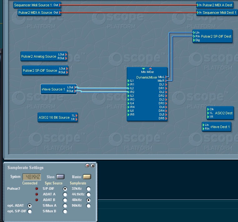

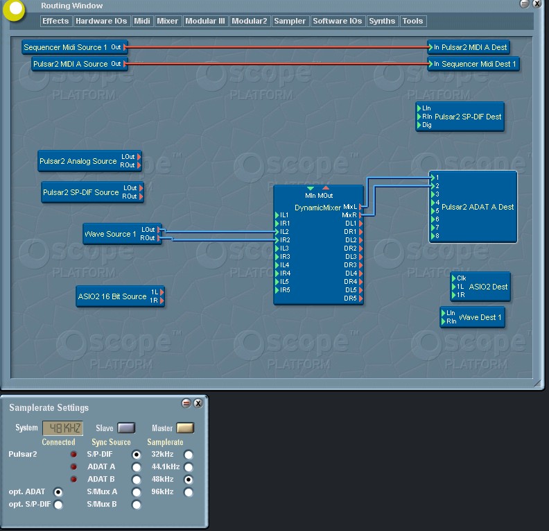

ok here it is full. this config ok for adat b but adat a does not work. if i select opt.adat on samplerate settings window, all sounds stop.look below; orvalis wrote:Show the FULL window please, not just that setting.

I believe usually, or always, you have to specify one card to be the master/sender, other one to be slave/receiver of the digital sync signal.  And you should get a red led shining next to the one you selected on the menu, when it syncs with the other card.
I was wondering about using both spdif and adat together, thanks fluxpod.
OK.
Right now I'm running my Scope card as master, with the spdif coax going to my Korg card on another computer. I specify the Korg spdif to be the slave, or it won't work. ( unless I do it the other way around, korg master, scope slave. ) One cable or two, spdif dest or both. And the red led lights up on the samplerate menu when the Korg-computer runs.

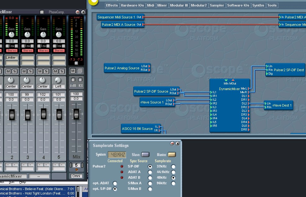

Again nothing wrong.
From the Scope manual under "I/Os & Drivers":
opt.ADAT selected: Each optical I/O operates in ADAT mode (standard)
opt.SPDIF selected: The ADAT A optical port switches to S/PDIF mode. The S/PDIF output signal is transmitted over both the opitcal and the coaxial outputs. The optical input receives S/PDIF signals, and the coaxial S/PDIF input is disabled. Use the normal S/PDIF source and dest modules in the routing window
So, you're using the wrong settings and the wrong i/o modules for SPDIF. Set it to Opt. ADAT on the left and use the SPDIF modules *only* in your routing window (completely REMOVE the ADAT modules). Sync source should be SPDIF also (it is in your screenshots, that part is correct). Once that's done you then need to figure out if the Soundblaster wants to be in master or slave mode when used via spdif. Set the Scope master/slave as appropriate (the soundblaster will probably be fixed).
(edit: the two posts above came in as I was typing mine
Ahhh thx for that valis! Long time no look in the manual for me....Interresting that it uses both opt and coax when switched to opt..but ok.
