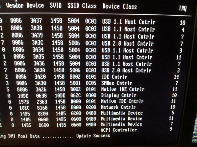

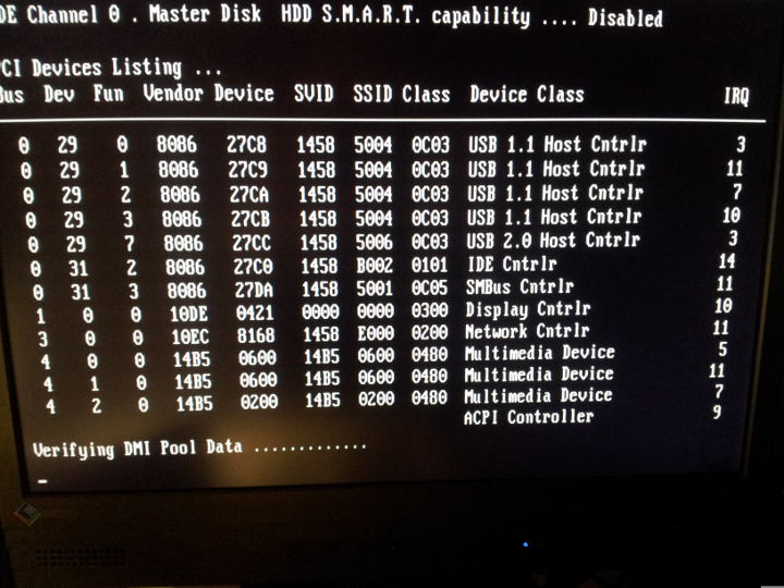

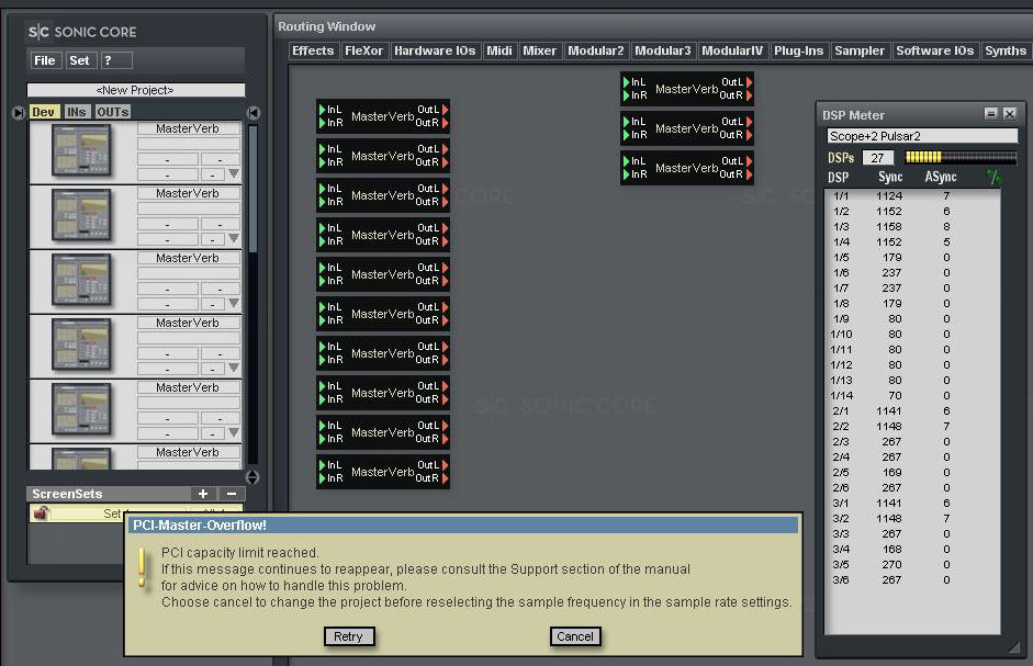

Just want to post my results, before I move to the new board. The system isn't optimized mutch. See IRQ table... Also not shure, that the test was set right... May too empty environment?
1)Motherboard, CPU and RAM
GIGABYTE GA-EP31-DS3L, Intel Core2Duo E8400 / 65W, 4GB (PC2-6400) @ WinXP SP3
2)CWA cards installed and eventual other PCI cards.
2x Pulsar2 + 1 Scope (Scope is wrong placed - an the edge of Mobo, max. distance away from the graphic card), no other PCI cards; Connected via two STDM cables
3)Graphic Card used
NVIDIA GeForce 8500 GT, 256 Mb DDR2
4)Number of Masterverbs loaded in an empty environment before PCI overflow is reached.
12, the at 13th the Overload message appears...

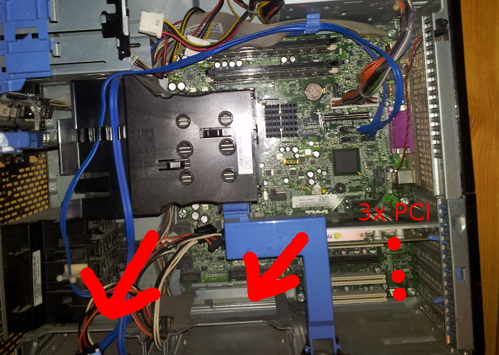

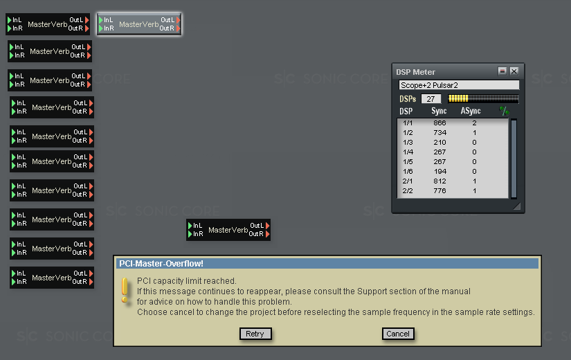

I tested one cheap DELL Precision 390 as a new PC. Just have to empty the tower and get rid of two hdd cages first. See also "How to manage a gap between PCI slots": http://forums.scopeusers.com/viewtopic.php?f=19&t=34597
DELL with Intel Chipset..., Intel Core2Duo E6400 / 65W, 2GB (PC2-6400) @ Win7 64Bit
A) Pulsar2 @ SFP 5.1 64Bit
B) 2x Pulsar2 + 1 Scope @ SFP 5.1 64Bit, Connected via two STDM cables
3)Graphic Card used
NVIDIA GeForce FX3450/4000, 256 Mb DDR3
A) 6x DCPs: 9, the at 10th the DSP-Overload message appears...
B) 27 DSPs: 11, the at 12th the PCI-Overload message appears...
Note that @ (B) the Scope card is not the forst one in "DSP Meter" window.
Pretty remarkable, that the difference isn't that big...

3)Graphic Card used
NVIDIA FX 1800 8500 GT, 768 Mb DDR3, with a fan
Also the same results as with my old board (GIGABYTE GA-EP31-DS3L, Intel Core2Duo E8400 / 65W, 4GB (PC2-6400) @ WinXP SP3)
- 27 DSPs: 2x Pulsar2 + 1 Scope
 - New_GIGA.JPG (96.45 KiB) Viewed 49021 times
- IRQs GIGABYTE_GA-EP45-UD3R

Got 7 verbs on
Pulsar2
HP Z800
						Pulsar2
HP Z800
