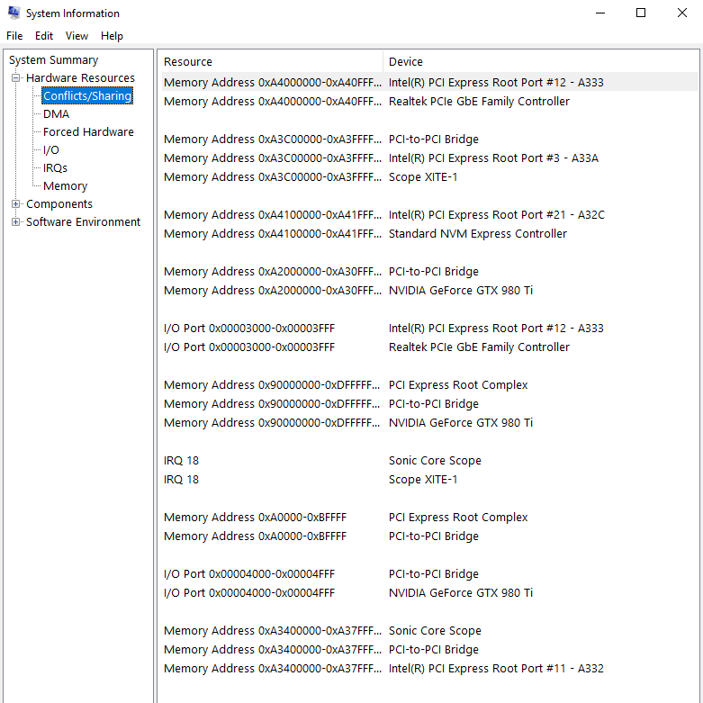

Conflicts 9700k build.png (47.99 KiB) Viewed 22324 times

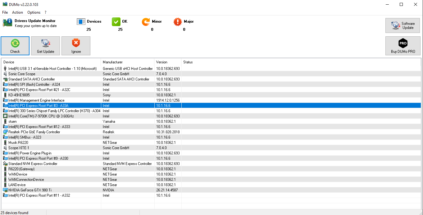

Drivers versions on new 9700k-pc.png (53.05 KiB) Viewed 22324 times

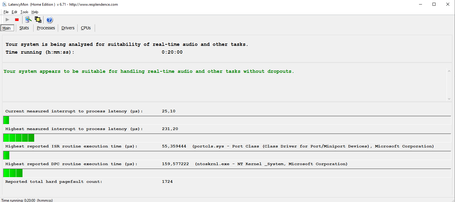

Latency Mon 9700k build.png (31.13 KiB) Viewed 22324 times

I don't see anything sharing any longer, each device 'shares' with the port it's attached to and no more from what I see in the first screenshot, so no issue there.
DUMo shows all drivers updated, so no issues there.
Is LatencyMon being run with nothing using the system or are you monitoring it under a workload of the kind that generates your clicks? In the timeslice shown there it's clearly not the cause of the clicks but...

Latency Monitor was running while I was running "my test" above.

Your LatencyMon readings are better than mine btw, I suspect there's hope.
